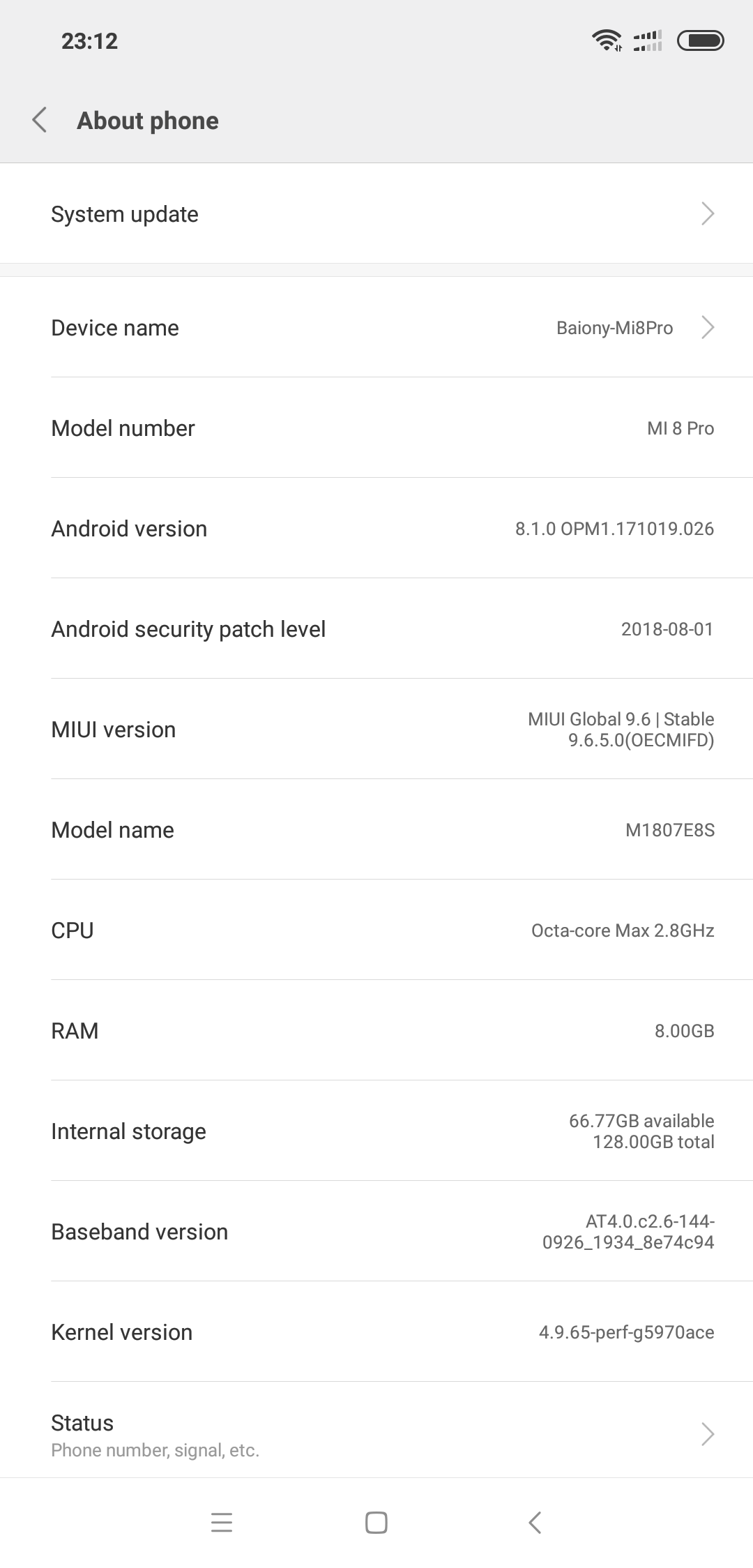

Ok ... I did it ! :D .. First, I downloaded the "Mi 8 Pro Latest Global Stable Version Fastboot File Download", then I unziped it ! After that, i modified the file "flash_all.bat" - I replaced on the first two rows the word "equuleus" with "ursa". I started XiaoMiFlash.exe with the phone connected in fastboot mode and flash the ROM .. after 10 minutes, flashed ok - Mi 8 Pro model ! It works perfectly, onscreen fingerprint is ok, but I don't have face recognition anywhere in the menu ... but, for me it's not a must ! :D

ok ... this is my "about" now .. it looks like a "mi 8 pro" version.
I set the region to "India" to have "wallpaper carousel" and "themes" .. I think the problem with face recognition is because Mi8EE has 3D face recognition and Mi8PRO has infrared face recognition .. I guess, I'm not sure ! :D
L.E. : I changed the region to Taiwan (or Indonesia) and now appear "Add face data", but when I try to setup a new "face" displays the message "couldn't recognize you" ! .. I think is a "driver" problem ! :)
