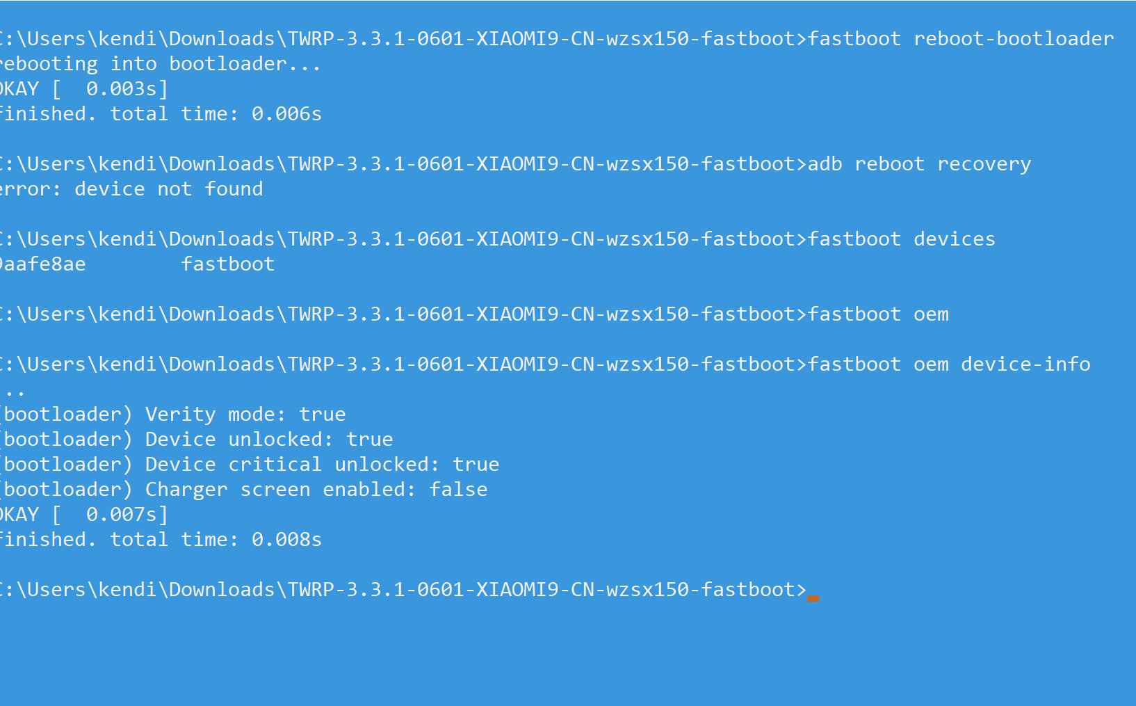

I checked using OEM and got this, still cannot boot into recovery.
Try
TWRP_3.3.1-35_cepheus_mauronofrio .
sahafdeen
Jul 14, 2019
62
{check Run as administrator}
fastboot boot twrp.img
Can't do anything soft-brick
flash your stock with mi flash tool [select unlock BL].
again flash TWRP !
THEN EUROPE ROM.....
