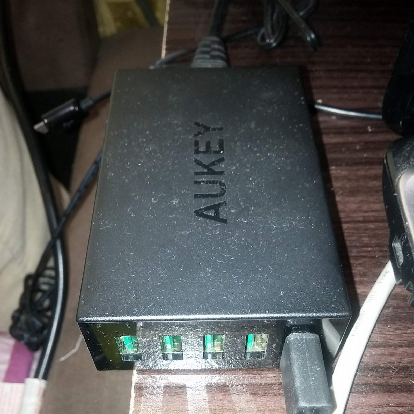

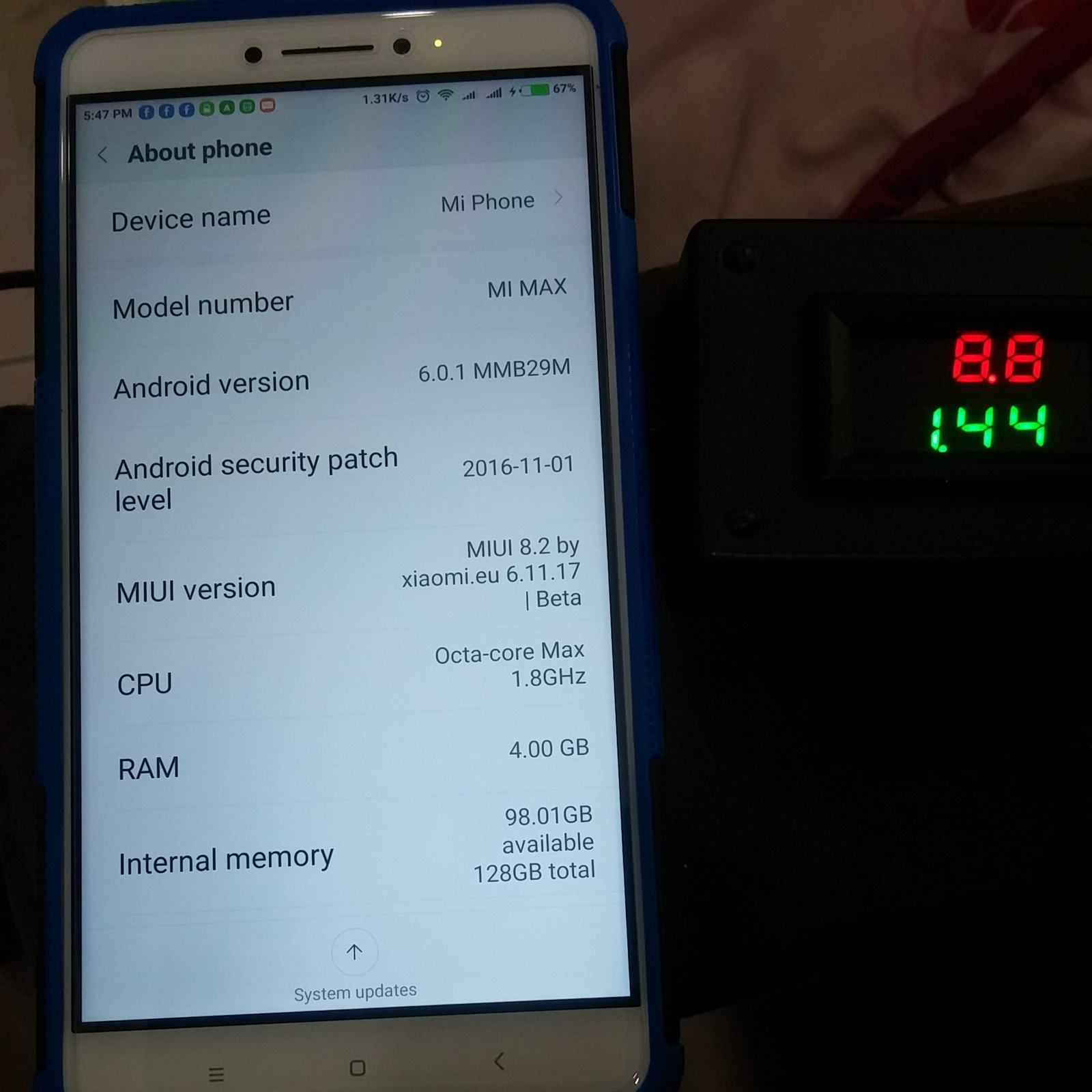

    I'm a electronics engineer and I've custom made a volt + ammeter to test the quick charge because Miui does not show Quick Charge info when plug into a Qualcom Certified QC Charger like other phones.
    I've confirm that Mi MAX come with QC3.0 but it charge faster with QC2.0.
    If you want to test your QC charger is working or not, you need to wait until your phone is fully charge. Pull down the notification bar and there is a charging notification telling you how much time it took to fully charge.
    Standard charger come with Mi Max took 2hrs 50min - 3hrs and QC2.0 charger took only 1hr 20mins.
    In the photo show that I'm using Aukey Quick Charge 2.0 Charger. Second photo show that my Mi Max charge at 8.8V 1.44A from my custom made device.

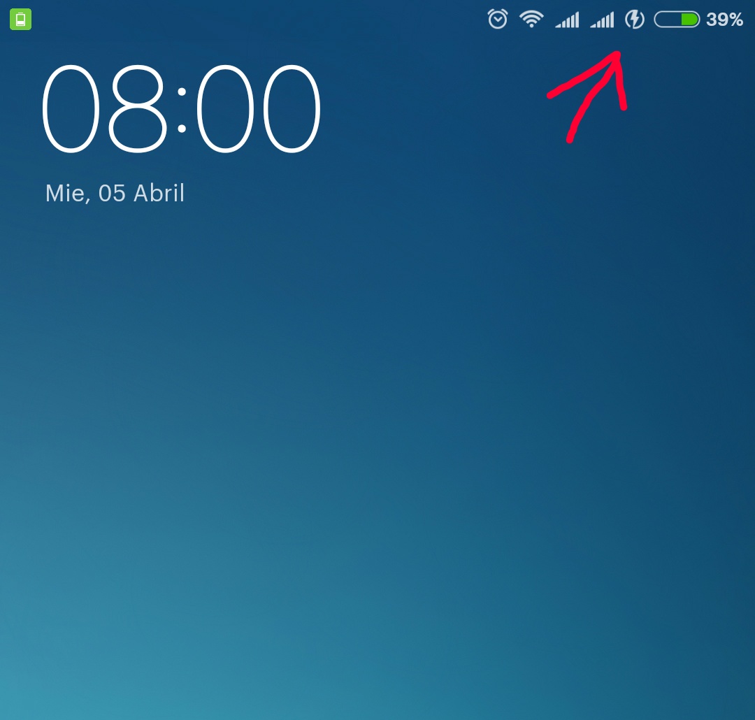

    When QC besides the battery icon there is a "flash" in circle it means it's working.Hidrogen latest developer N,now about 2 hours full charged before about 3h 45m

    Is this the "Flash" Icon you are talking about? If it's this one then this is just how the charging indicator looks like... I get this icon even if I charge it from a PC's USB port...
    If it is something else, please provide a screenshot.
    I'm on the latest MIUI8.2 7.3.30 Global Dev and I've never seen a different/additional icon exept this one (and the green one in notifications showing the remaining charging time)
    Also for me the charging time (from about 15% - 20% ) is always about 2:15 - 2:35hours... It was like that even with the stock charger!
    Yes that one but you don't have a circle so no QC.
