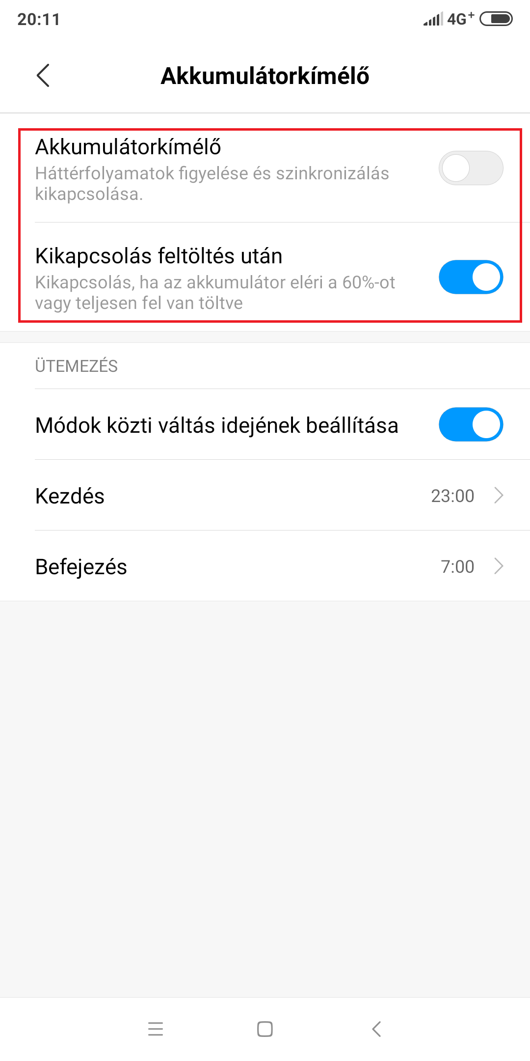

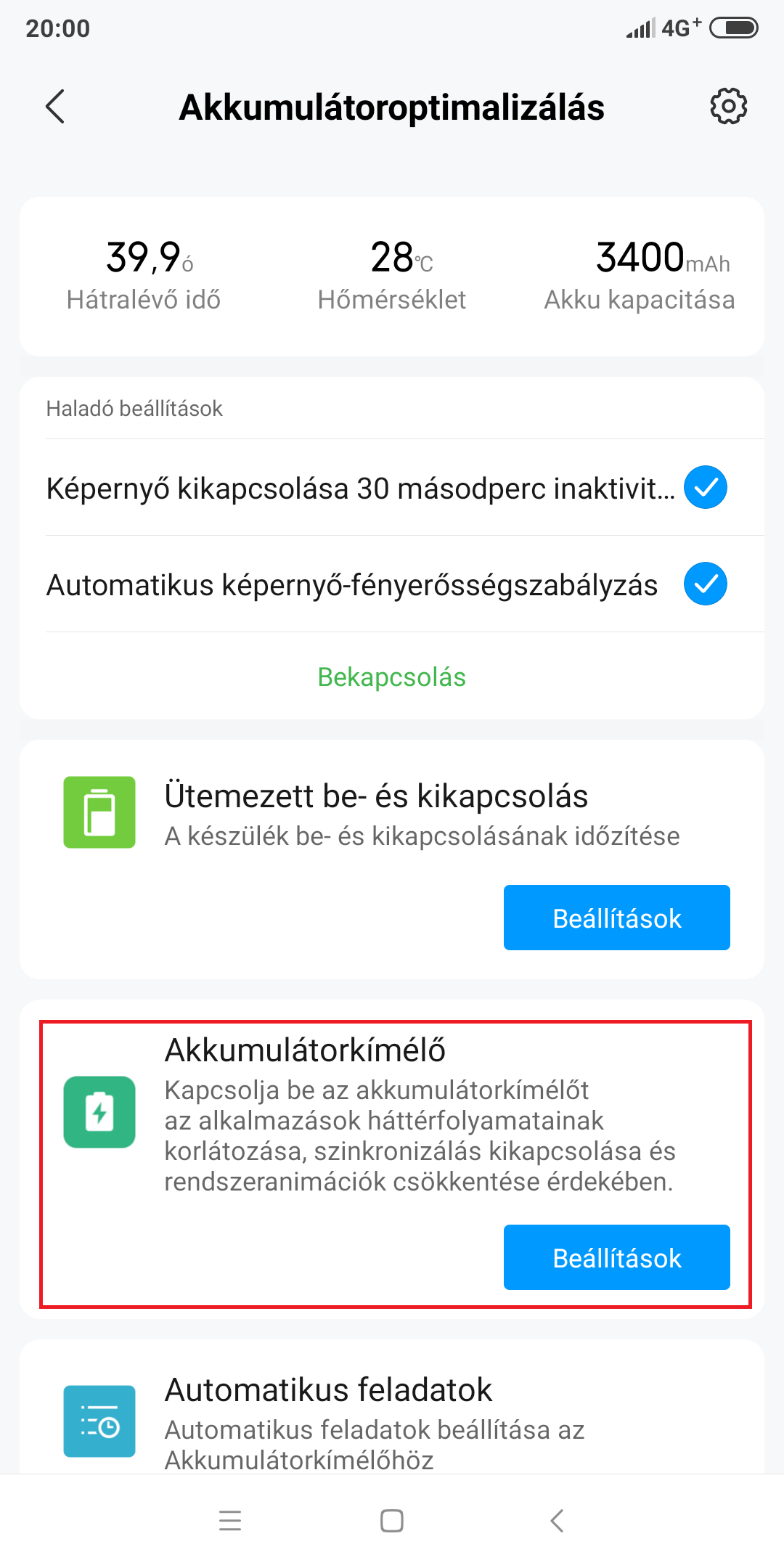

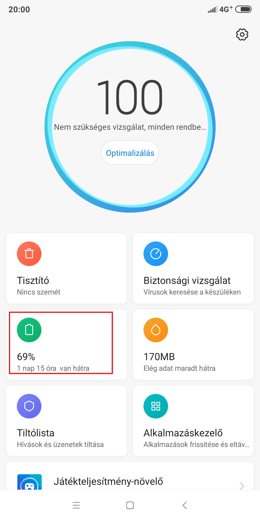

I was thinking that if charging at night would turn off the battery saver function. (attached previous 3. picture)
I use eu. beta rom line (9.3.14), and Intenso B1 (QC 2.0/3.0) charger.
