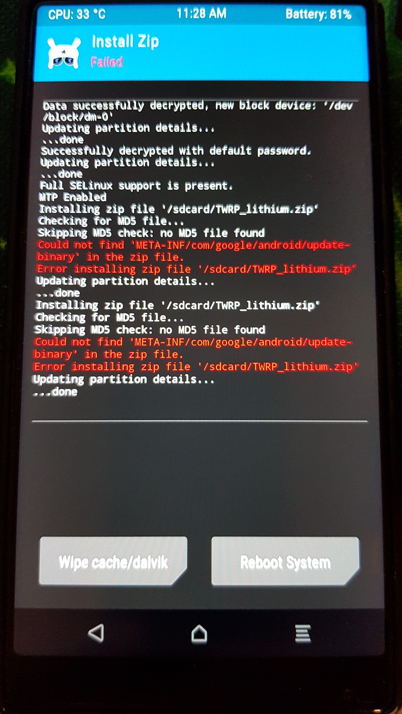

I tried to install the miui 10 in the mi mix and it gave error
I tried to update the twrp and it always error
Does anyone know why?
here is the error photo

How do I install twrp?
I have 3.0.2.0
but this one can not install .. is not in zip.
I can not understand how I can install this twrp. My English is not very good.

"Windoze box" means any computer running Windows, sorry.
You need to install the new TWRP from a Windows computer over an USB cable, using the fastboot utility.
There are instructions how to do this in various places, l don't have a good link at hand just now.
How did you install the TWRP you have now?

Or in TWRP select install image and select TWRP
Problem is I think he has the old TWRP by Mr.Raines/Mr Tomatico, it would not let me flash another TWRP as an image when I had tried it and wanted to change back. I had to fastboot flash the other TWRP.

install image I have 3 options
boot
recovery
system image
I tried the 3 and it does not work
and yes I have this TWRP by Mr.Raines / Mr Tomatico
How do I install another one now?
by usb how can i do this?
