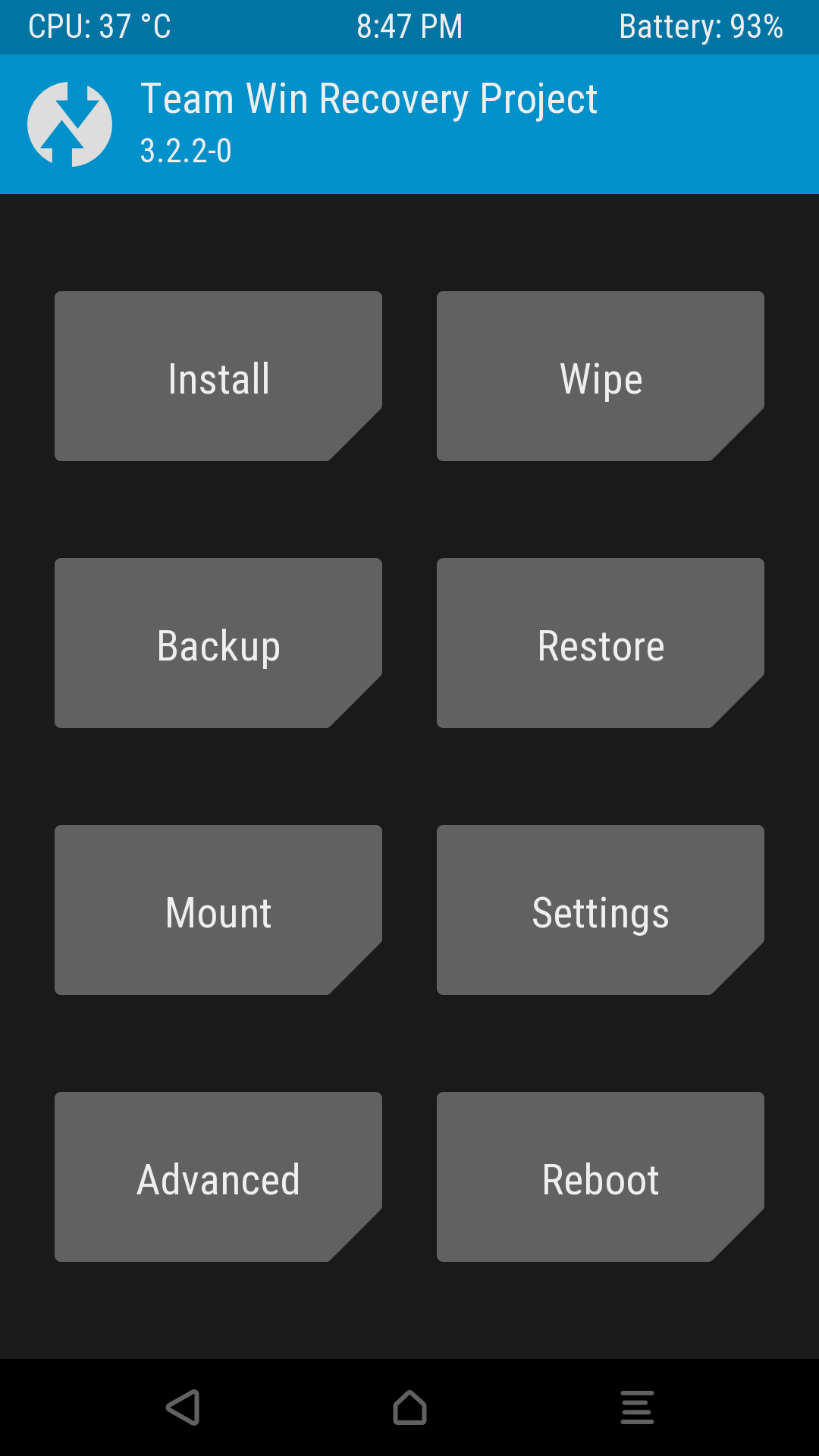

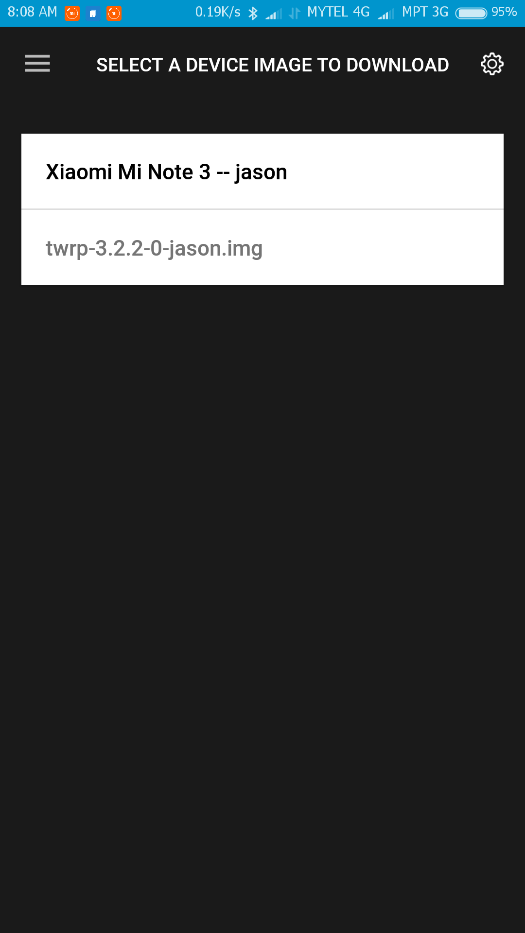

Official TERM for Mi Note 3 is released for MIUI 10 with Oreo support.
Download available via official TWRP app.https://twrp.me/
https://twrp.me/xiaomi/xiaomiminote3.html
