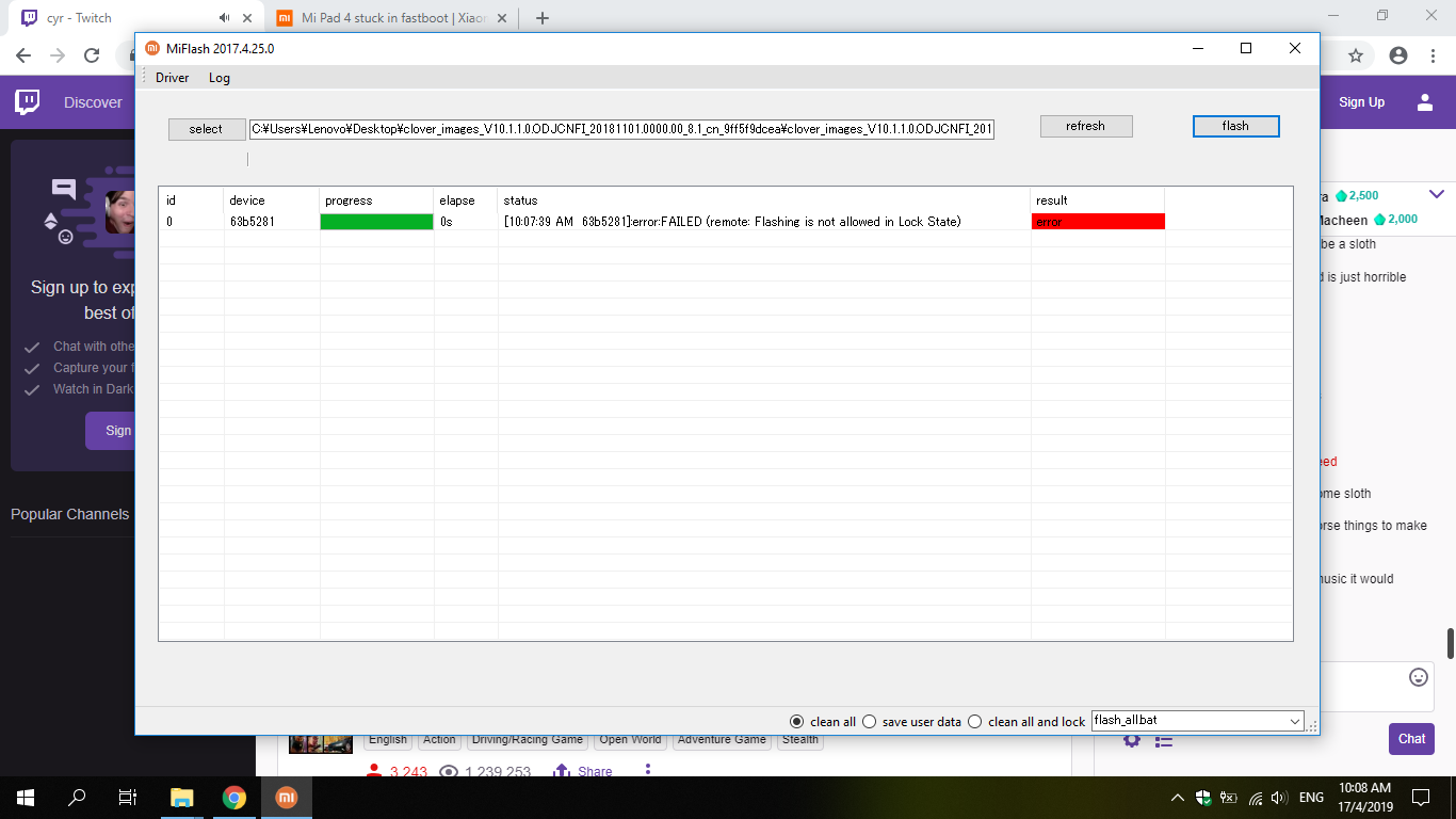

I'm able to get the fastboot detected on my computer but when i use the xiaomi flash tool and try to flash a ROM it keeps saying "flashing is not allowed in lock state".
i'm not sure what to do since i can't boot into the device to unlock the bootloader

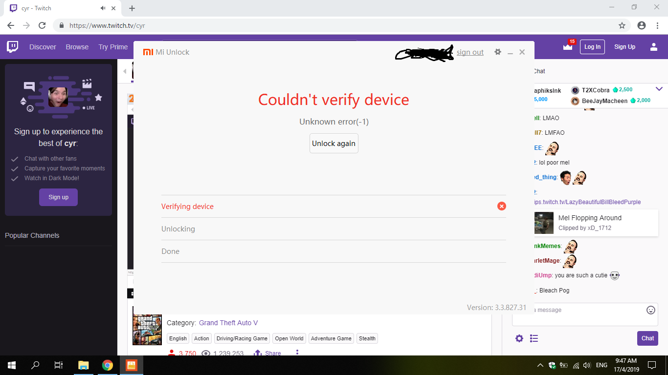

Tried unlocking bootloader but it came back as "couldn't verify device" and then some chinese writing below it i couldn't understand. In the past when i unlocked my bootloader i had to set up "find my device" and then it was able to unlock but now i can't do it anymore since i can't boot into the device. Is there any other method left?
Try it again, take a screenshot, and either post it here or use Google translate to translate the Chinese error message to your language.
Unknown error (-1)
Flashing using xiaomi flash tool. flashing official ROM
