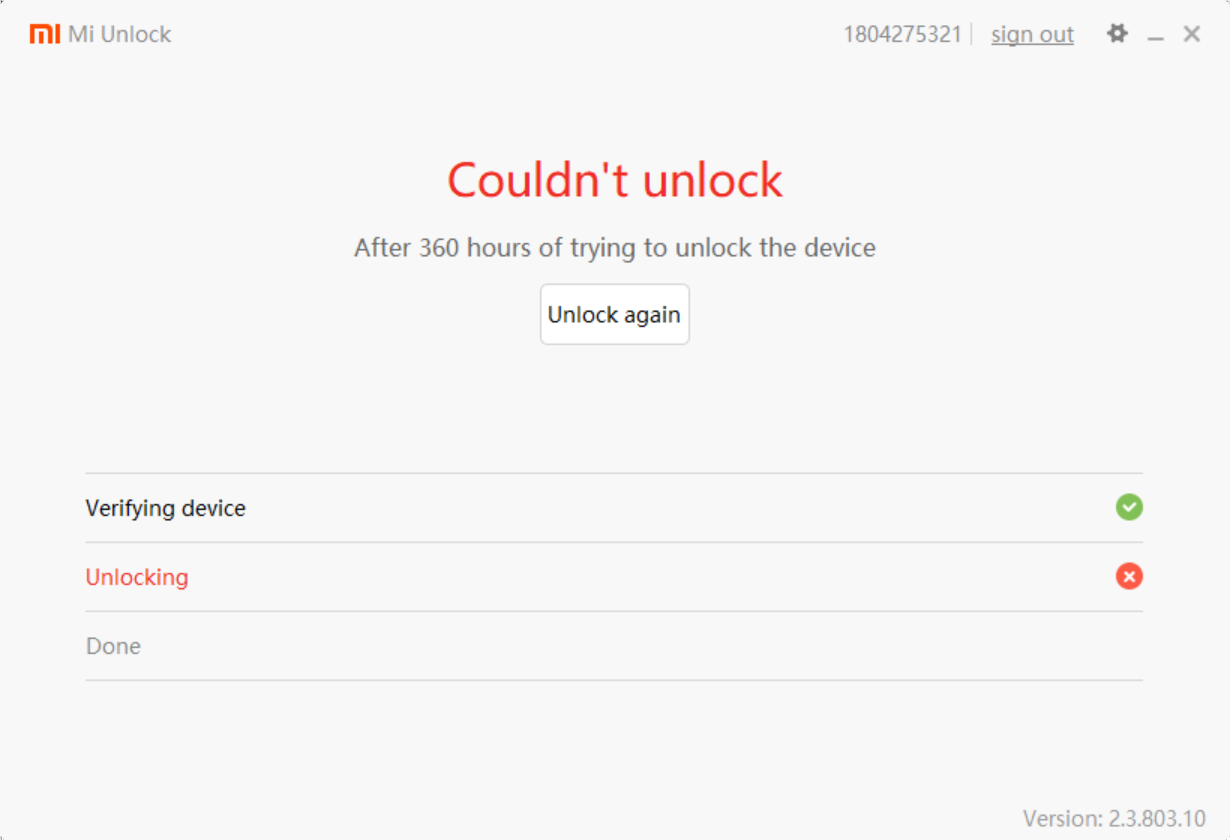

i did reach the "Mi Unlock Status - Sign in", menu, it said success after pressing the add button.
but when i press the button "OEM Unlocking Enabled" it goes back to off,
when i use the unlock tool, now i have this message !
google says i must wait few days before trying to unlock, I'll try later
you have to wait 15 days
Gran's
Jan 29, 2018
11
Waiting didn't do anything on my phone, using a chineese VPN to associate account and phone did
