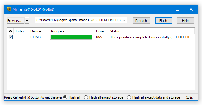

I bought Redmi Note 5A (China Version) from Fast Tech website. They installed Global ROM (Maybe fake ROM). When I check Mi Unlock Status, it shows "This device is unlocked" But actually the device is locked. You can see in the picture. I would like to unlock the Bootloader. When I try unlock the BL, Mi Unlock tool shows "Current account is not bound to this device".
If you can help me, I will very happy ;)
any solutions for that, i get same problwm, i was use methode test point to enter edl mode and flashing with china version, but not affected....
my mi account status still unlocked
There is only solution "test point". I have done. Try again. You must use MiFlash 2016.04.01.0 (64bit) for install ROM.

i was doing test point to enter EDL mode and flashing on your instruction..use miflash 2016.04.01
before i flash and use chinese rom global stabil
now i revert back to global stabil miui 9.5.6.0 (OEIMIFA) With sukses....
but mi status still unlocked

i think is not about fake rom, i was flashing on officialy rom, i dont know why ? , mi status still unlocked device
i hope is bug.....
