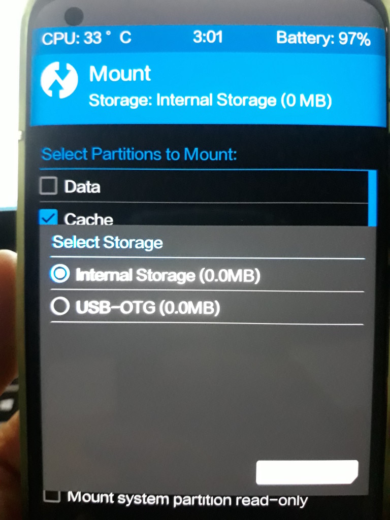

Trying to revert to previous version I installed xiaomi.eu_multi_MI10Pro_V12.0.4.0.QJACNXM_v12-10.zip from TWRP and i get a bootloop. It only boots on TWRP and i can't mount data partition. It says "Internal Storage (0MB)"

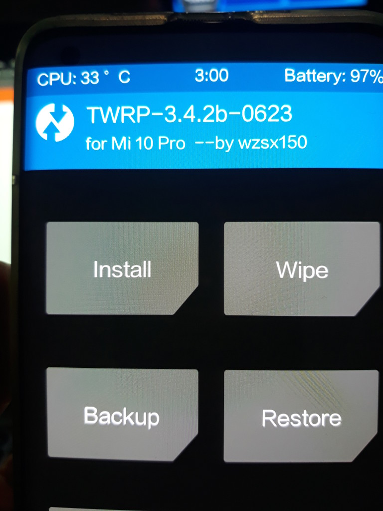

I can reboot but it only boots on TWRP. I have TWRP-3.4.2b-0623.
I don't have magisk installed. It was not rooted.
This is the TWRP thas i have installed and it doesn't recognize any partition:

I have format data, then a can mount the partitions.
I have flashed again the rom but it doesn't boot.
It only boot to TWRP.

just wipe the data the option that needs you to write yes to continue once u do just reboot to bootloader -fastboot- and boot recovery from fastboot dont use the install command because that will cause that issue so steps are
1- Wipe Data in TWRP - write yes to continue
2- Reboot to fastboot mode
3- use command -Fastboot boot TWRP IMG (use latest twrp version 3.4.2 1206)
4-Copy new rom to phone by cable or use OTG usb stick
Best of luck
