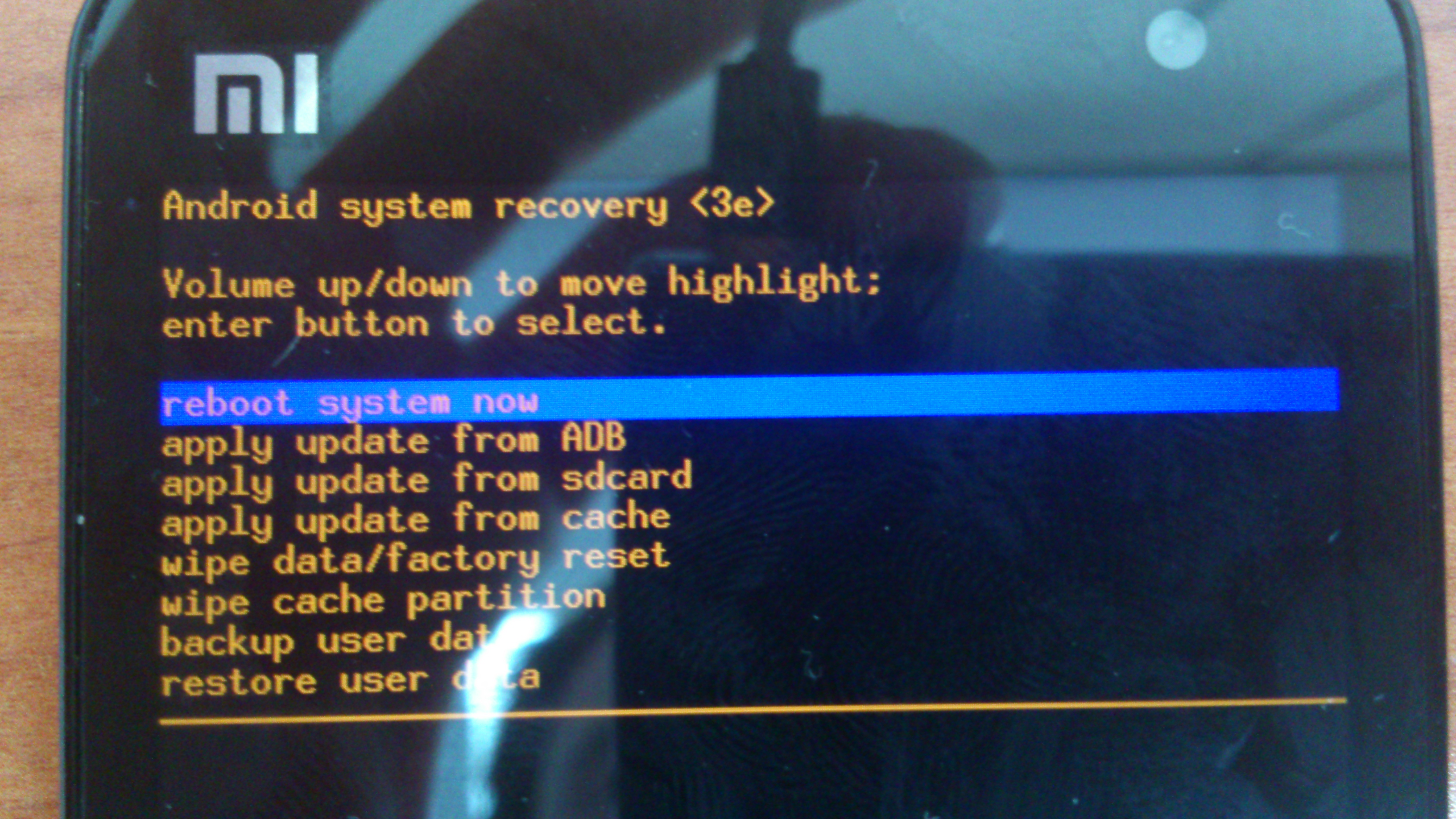

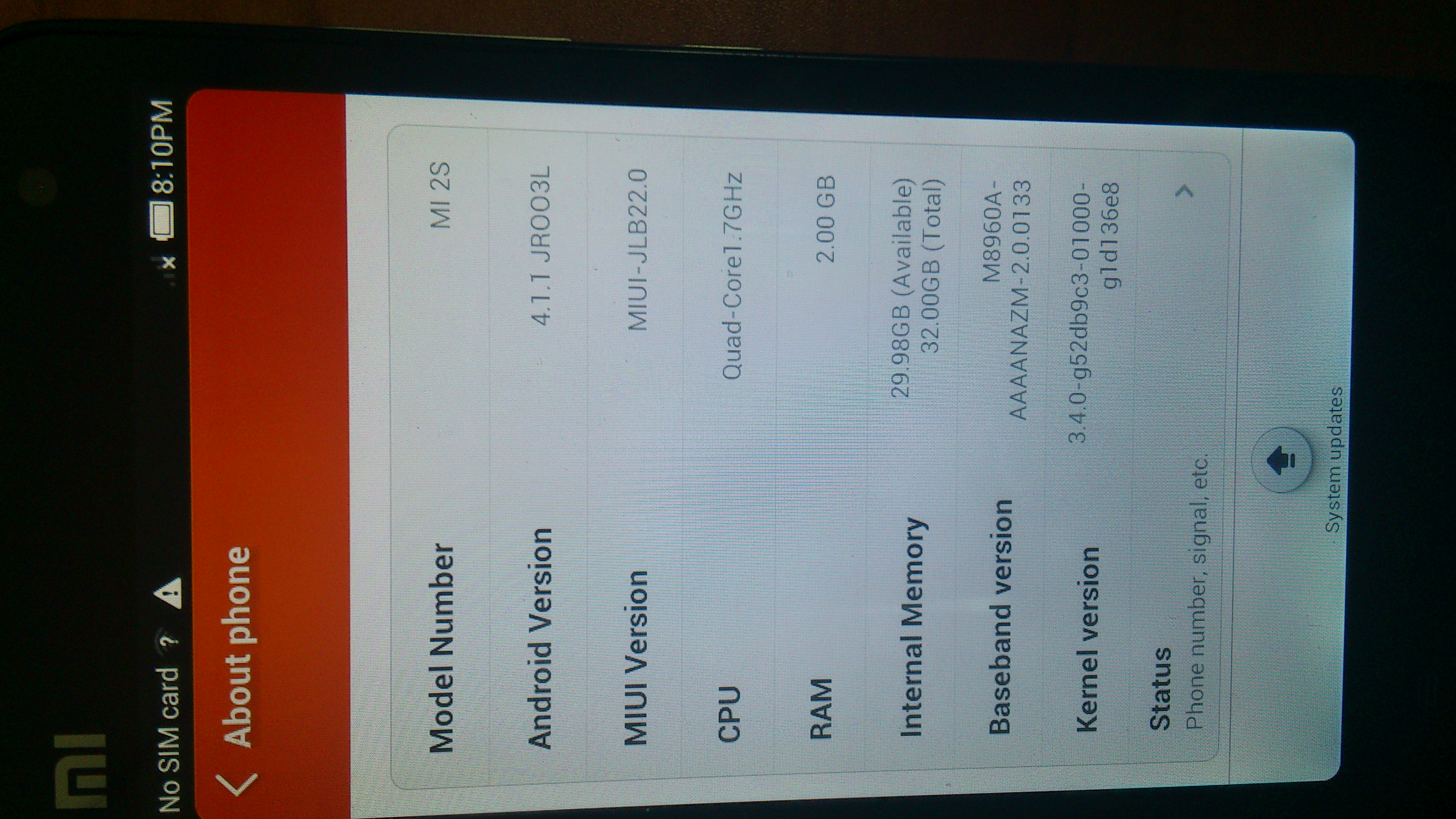

    I got my mi2s 3 days ago (from aliexpress). when i inserted my SIM card, the device was pointing "no service" and i notice that when i try to do "settings" or any other application, the application closes immediately with no warnings.
    so, i contacted my carrier, and the answer was "no supported" (of-coarse...)
    since then, i am trying to gain root access or flash any other ROM using lots of methods, but, no success.
    the situation now is:
    1. my pc detects the mi2s correctly.
    2. i can do adb to the device.
    3. can not do fastboot (fastboot devices does not recognize any device although the driver is installed from android sdk)

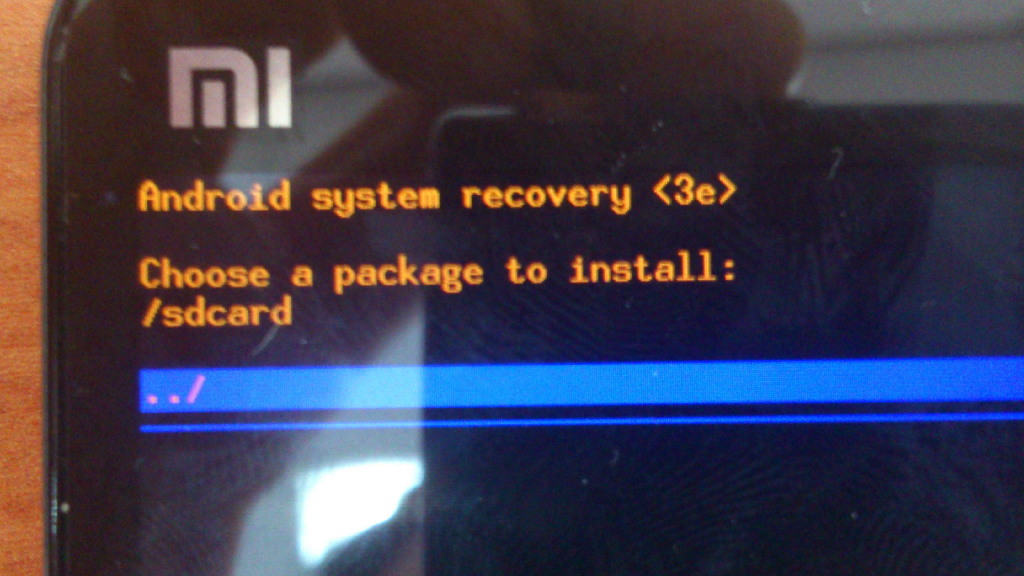

    4. the recovery tool in the "android recovery 3<e>" and does not find the update.zip i copied to the sdcard.
    5. the updater of MIUI closes immediately when i choose any zip file to install.
    6. MiFlash does not recognize the device.
    pretty much exhausted .... :-(
    any one has any idea?
    i attached some screen shots.
    thanks,

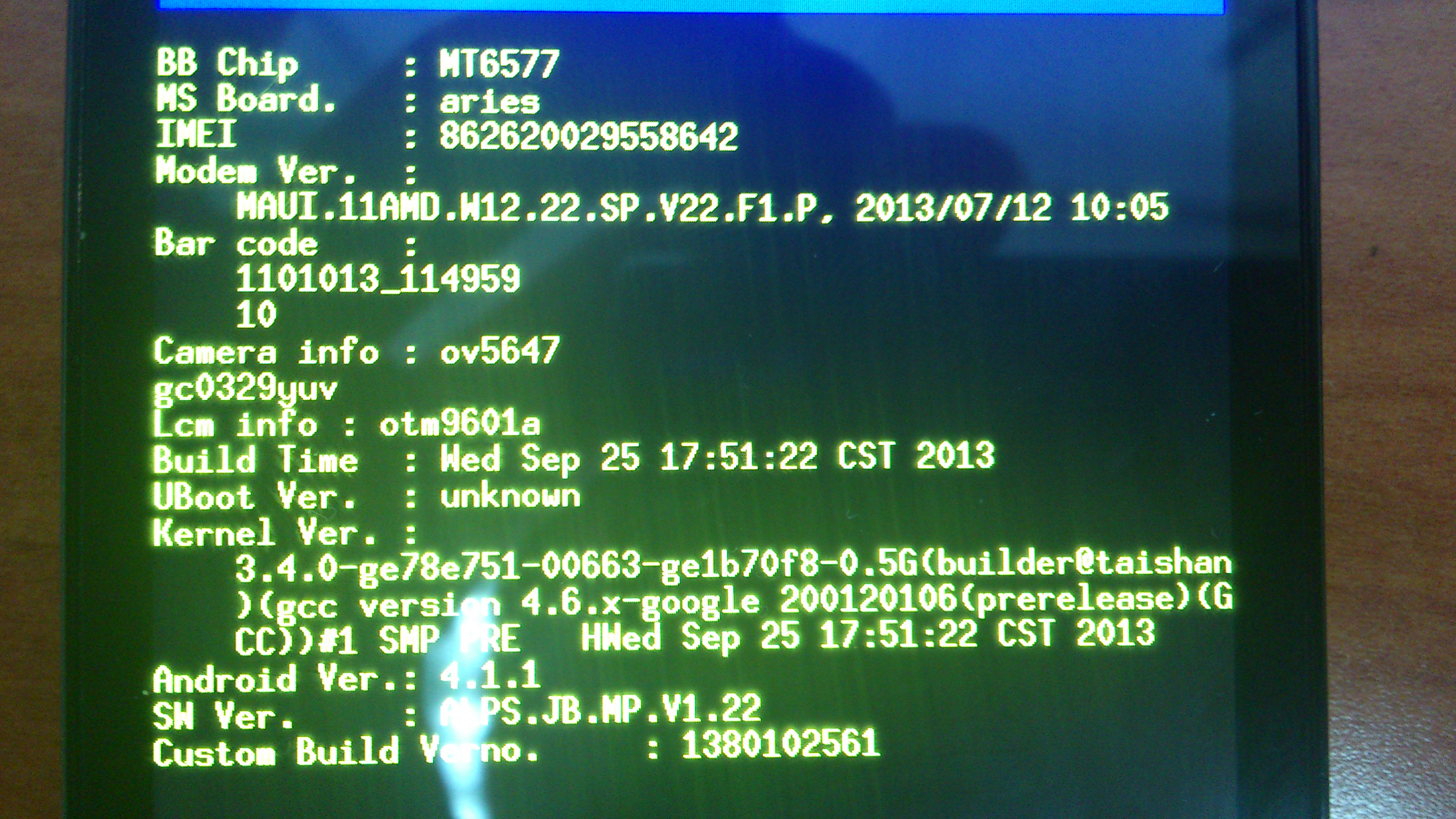

  7. zipalign
    zipalignMembers
    Sep 9, 2012
    211
    218
    67
    genuine xiaomi phones come with mi-recovery installed.
    you have a standard android recovery and a mediatek CPU. this is why it's fake.
    sorry.

    It's obvious fake phone. Nothing can be done. No updates. No nothing. You can use this phone as a stand under cup of coffee or return it to seller.
