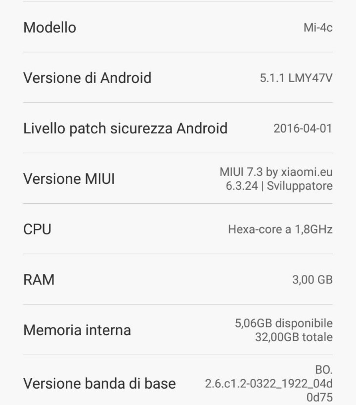

Tnx for your reply.
Both smartphone should be the same...
3gb and 32gb read on Settings -> phone info.
I've been taken this picture after wipe data, interna memory, dalvik and cache
As you can see, I've only 5,06GB of 32GB in a just formatted smartphone.
Can I check something else?
Regards
