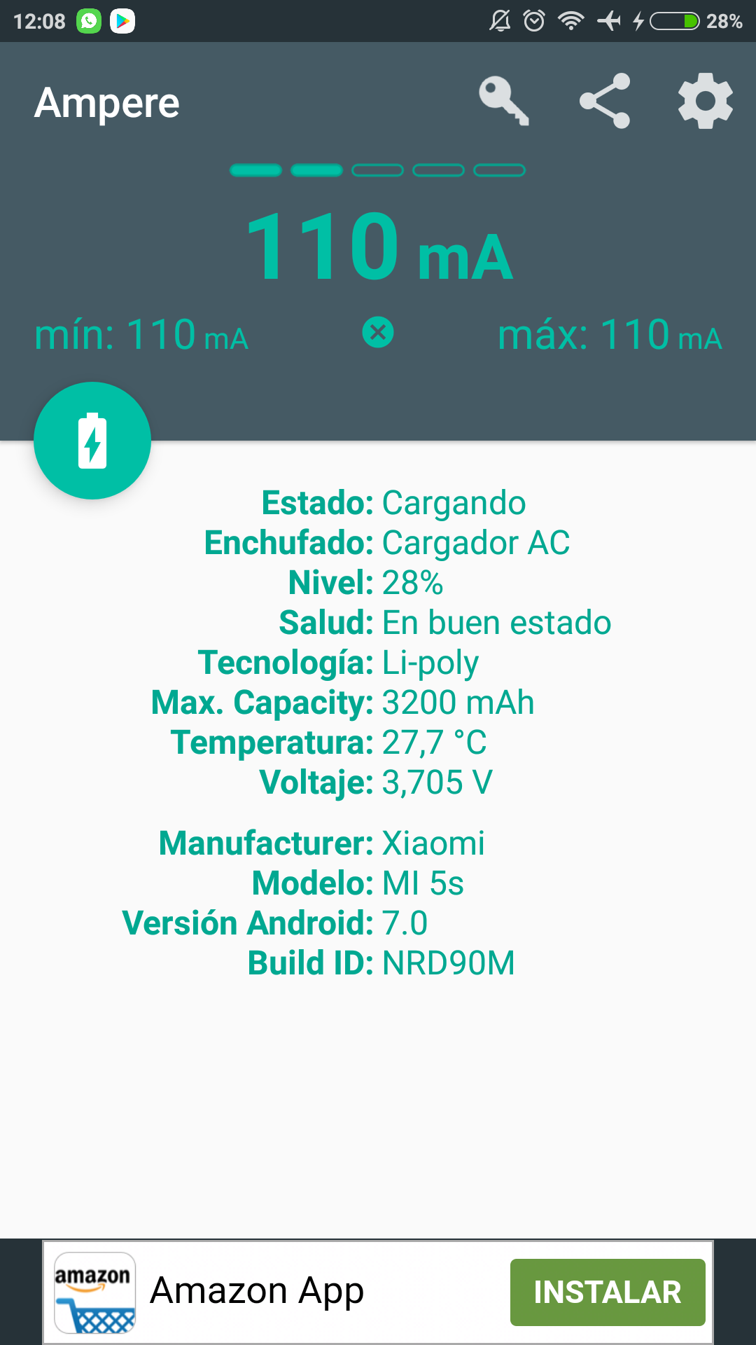

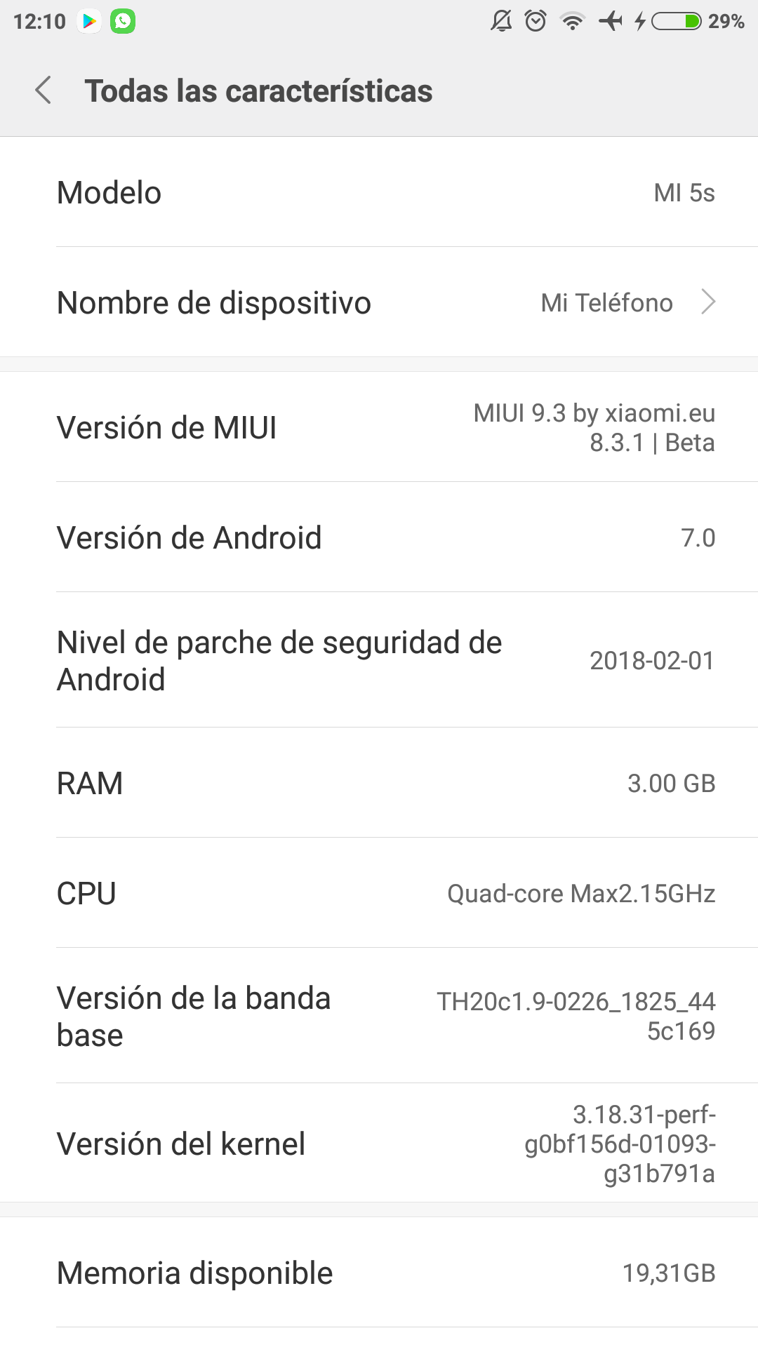

Hi, since two days ago my Mi5s 3/64 suddenly started to take a lot of time to charge, even when I was using it when charging, it loses battery instead of gaining it. Tonight I put it on airplane mode with 1% and after 10hours it is in 30%. Maybe hardware problem?
I tried original Xiaomi charger and qualcomm Quick charger
I tested both,, original and aukey. The aukey (with the Quick charge) goes a little bit faster, but not working properly. Should i try to clean everything and change the rom?

Tested with ampere apk.
