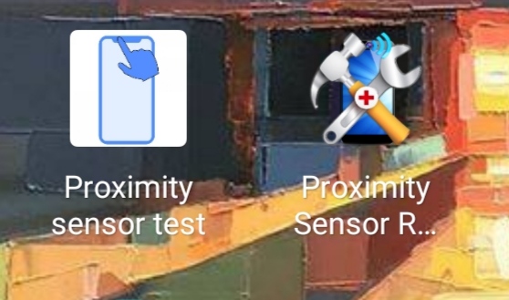

I had a similar problem on Mi 9. Try use these apps. It solved the problem for me, also I calibrated the proximity sensor on 7dB and works for me.
