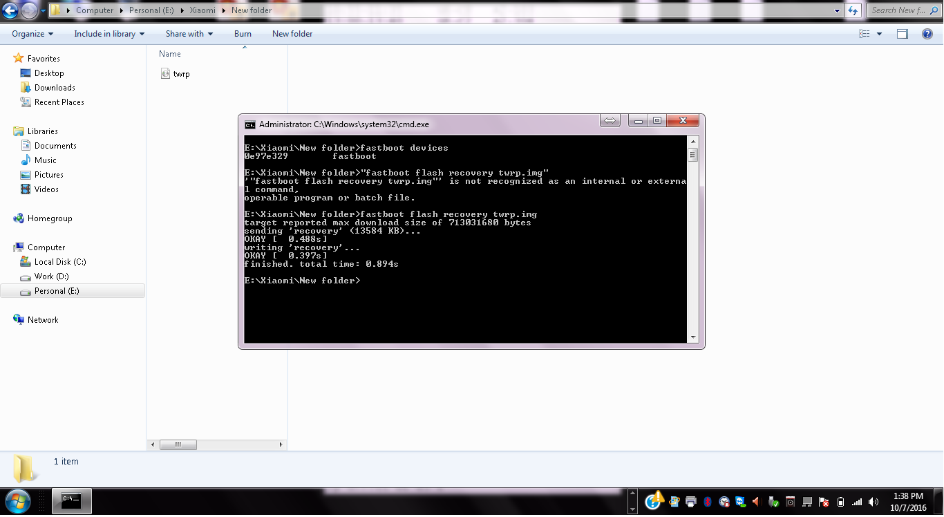

I follow the instructions step by step. The adb installation in the command prompt completed as in the video. But, for some reason when I go to recovery it is still MI-Recovery 2.0.1 it is not the TWRP recovery. I am not sure what to do next???

U can try flashing twrp with twrp flasher(doesnt require root).u simply google search for xiaomi twrp flasher v1.0.0.1 for windows &follow the thread in miui forum.
I tried that and it says not responding. Is there a bootloader issue?

Actually 1st time ,mine also showed not responding 2nd /3rd time it worked..first of all enable developer option(tapping miui version 7times) & enable usb debugging &then manually go into fastboot mode(power off device ,then vol down+power button);open twrp flasher with mi3 connected,untick adb bootloader&flash.(try for 2-3 times &ur pc should have internet connection for dwnlding twrp recovery file).this should work.

it said completed but when it boots to recovery it is still the mi recovery not twrp.
Which version of miui rom r u using?is it official?plz share screenshot.do install mi flash,mi pc suite,minimal adb &fastboot.if u r using any marshmallow rom,google search 'root any marshmallow based miui rom without losing stock recovery' .follow the 1st thread (search twrp recovery for mi3& dwnld it).after rooting ,u can install flashify from play store &flash twrp. If still not working,u can flash any chinese /global fastboot rom through mi flash(just google for it) & then 1st try using twrp flasher(bfor flshig do mention ur android version as if u r on kk rom ,need to merge partition bfor flashing mm rom)
If it is kk rom,first dwnld any official kk based miui rom(miui5;miui6&upto miui 7.1.2 global/chinese stable fastboot rom).flash through mi flash &then u should get ota update&update upto 7.5 /8 stable(mm).actually 7.1.2 merges partition.then after enabling usb debug........try flashing twrp using any of the above mentioned method.
