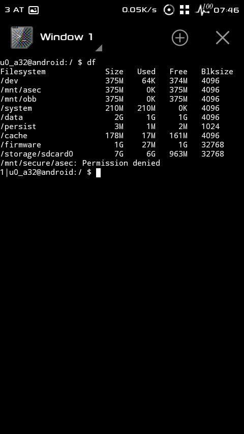

Connect your phone to adb or install Terminal Emulator from Google Play and run "df" command. Then make a screenshot and post the results.

here it is
Well no surprise. You have no space left on /system partition, thats why some random system apps are missing.

so to which build should i downgrade? afaik i didn't install any other mods, maybe having a 2nd partition with v5 takes too much space

ok, so i deleted a few files in the /system folder and got 19MB of free space. i managed to change to the 2nd partition and there i still had sms, settings and the updater app. finally i updated to 3.11.15 and everything seems ok now. thx for your help!
