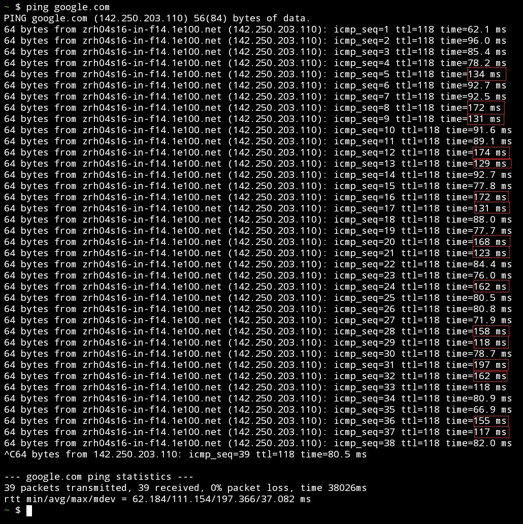

there is a problem with 5G connection on Redmi K40 Pro+, every other packet is lagging on transit/receive. Just like when the connection has been jumping between LTE and 5G constantly, except the icon does not change and the connection is established, but "choking".
This leads to disconnections and lags.
Tested after clean install, both SIM card slots, different SIM cards and networks.
If set to LTE only, there is no lagging.
Please fix,
thanks :)
Reactions: KDR66
