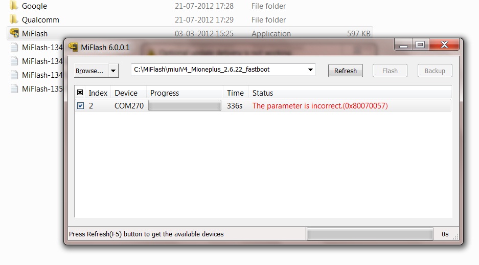

Tried all three tests and all ended up NO for me :( ! phone does not enter fastboot under any test.
But, when i press Mi-Button + Volume & connect to PC-USB, it installs a Qualcomm QDLoader 908 drivers (everytime i connect) and shows the device in the Mi-Flash Software. If i try to flash anything, it shows an error with parameter (image attached).
I m not sure what that error means, but i guess the fastboot isnt working or something with the bootloader is pretty ****ed up

check your settings for miflash and you cant flash unless you are in fastboot mode :(
you must have broken something but not sure what you have broken since you cant enter fastboot mode.
Must be something at the very bottom of the software maybe you have broken.
The only option is probably to contact xiaomi and ask them for help.
