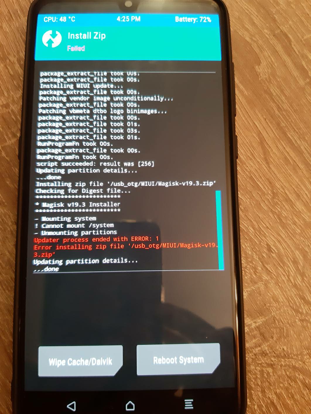

Hello again
So I flashed TWRP and ROM :)
However, I Got an error with Magisk...
And I'm missing Play Store and Google apps.
Is it because the device iz not rooted?
Any idea what to do?
EDIT: Play Store is OK and Google apps as well, need suggestions only about Magisk...
25914
Edit: Go Back to twrp a flash magisk again.
Do you have try to flash magisk from internal partition too?
And wether the report ist again "cannot mount system", -
Edit: do you have try to unmount system in twrp, and after that flash magisk from internal?
See linked post from matata86 and andere from Clipcarl in XDA
