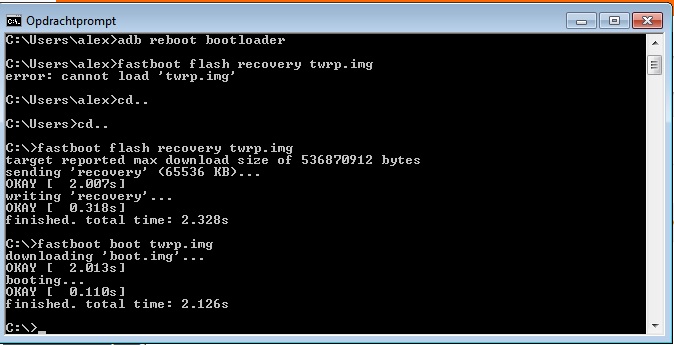

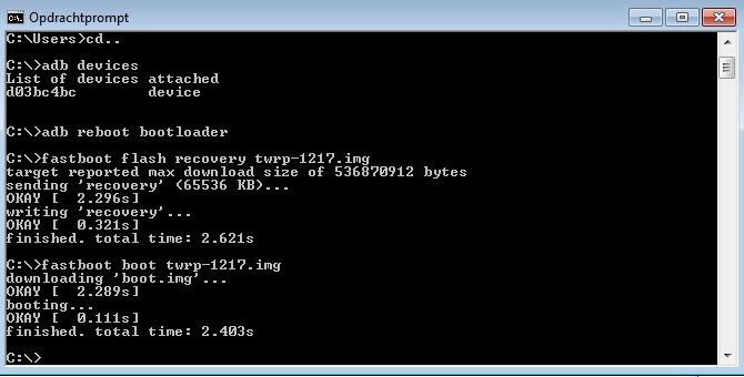

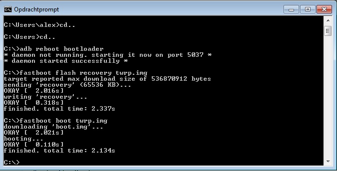

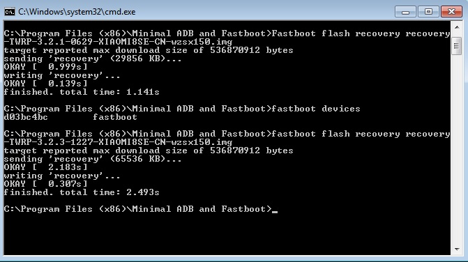

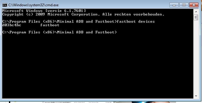

Well i must do something wrong, started all over and made some screenshots. Saw your excellent video, did exactly the same, but?

Start your phone in normal mode and connect it to pc. Type these commands in adb command propmpt:
adb devices - your device should appear
adb reboot bootloader
fastboot flash recovery twrp.img - rename your recovery image to twrp.img for convenience
fastboot boot twrp.img
And you should be in twrp.
P.S if this doesn't work try to install these adb drivers while your phone is connected to your pc https://forum.xda-developers.com/attachment.php?attachmentid=4623157&d=1540039037

he has ADB set and working because he is able to install twrp file.
Issue is about reboot.
Yeah I posted it as an alternative - sometimes for unknown reason the method simply doesn't work. Also I posted the command to boot directly in twrp after flashing it.

Thanks guys for your time,
@LOLO9393 " After install you must reboot hard mode: vol+/power" I've tried this, but it doesn't work .

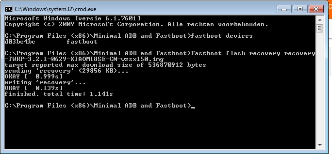

@ werty, tried it, then installed the other adb drivers, reboot the pc and tried it again. Screen of the phone stays now black/off and when i use the vol+/power it goes in Fastboot. When i use the power, phone starts normal, but still the chines version

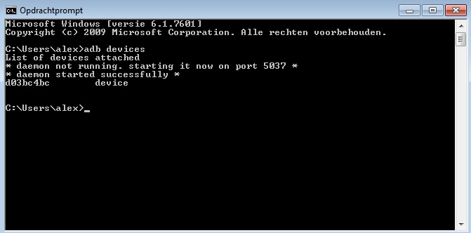

Your Bootloader is unlocked for sure?
Verify the statues in mi unlock tool or by issuing < fastboot oem device-info >
I've checked again what you have '(well) done.
suggestion:
- try twrp 1217 (because it may better fit with this stable rom version as it has been a move on it)
- if not successful, you go to cleaning all by flashing fastboot room 8.12.27 or earlier.
-then flash 1217 again (it should stick)
now you are ready to update and flash with 1227 release.
tried twrp 1217 and it worked, so followed the video and when i reboot it, it went in a fast boot loop.

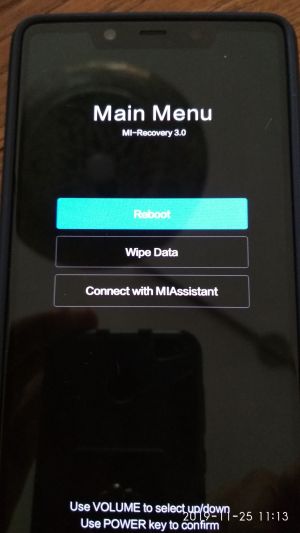

Flashed 8.12.13, flashed 1217 and updated in twrp to 1227, then reboot, waited for about a half hour and the only thing i see is the white Mi icoon, with unlocked at the bottom, tried the volume+/power, but then i get a menu in Chinese, with 3 buttons, reboot, wipe and ?? Mi-menu ?? ( Google, i don't speak chinese)
