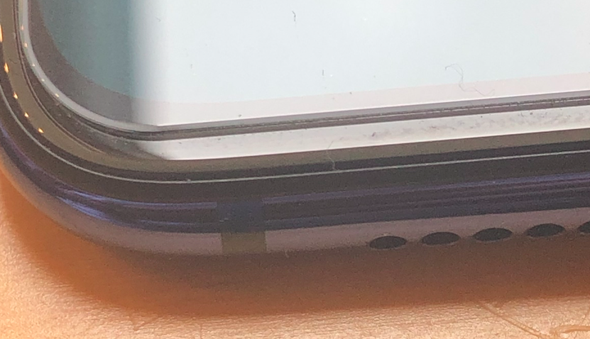

I am, in fact, using one :) Look right under the notch, and also all around the display, you can clearly see a straight line further from the edge.

You can see it better here. Do you see that "double edge" thing, at the bottom. It's a screen protector ! I watched a couple of videos where the guy used it with and without screen protector, whether it was tempered or not, and I could not see any distinguishable difference
