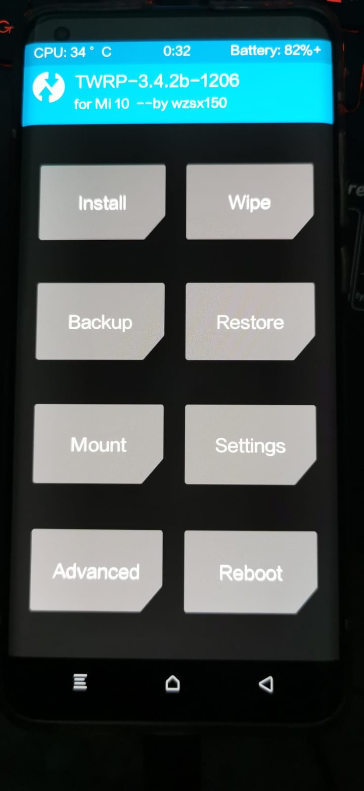

Ok, i tried on Mi 10.
I flashed with fastboot bootet 3.4.2b-0623 version on recovery partition.
Twrp 3.4.2b-1206 dont boot wether in recovery nor in system, it boots in fastboot.
I flashed the old 3.4.0 booting recovery back to have an working system.
Later today i will flash only with fastboot ....

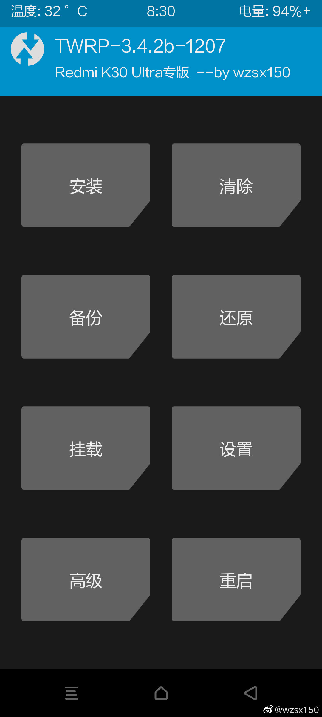

If you use the Google translator you can see that the Twrp in question is only and exclusively for Redmi K30 Extreme Commemorative Edition. Therefore, please do not use it absolutely for the various Mi10 series

@Mali2
various Mi10 seriesView attachment 33273
Recovery for Mi 10 is from december 06 and is for both, android 10 and 11.

I just unlocked the Bootloader of my Mi 10 (umi).
I was on official miui EEA stable.
I did to test
Code:
fastboot boot recovery-TWRP-3.4.2B-1206-XIAOMI10-CN-wzsx150.img
= OK
So
Code:
fastboot flash recovery recovery-TWRP-3.4.2B-1206-XIAOMI10-CN-wzsx150.img
fastboot reboot recovery
It's working fine. I did format my /data partition. Now I have to install weekly EU.

This new recovery for Mi 10 is for Android 10! Same problems as older version!
Superwitschi Designs
Sorry i am now back from work -- long turn today, have just tried different flashes and reboots with Mi 10.
I think Superwitschi ist right!
for MI 10: TWRP-3.4.2B-1206-XIAOMI10-CN-wzsx150.img only boots from fastboot, or directly from phone on Android 10
It dont boot with Android 11 and new kernel.
