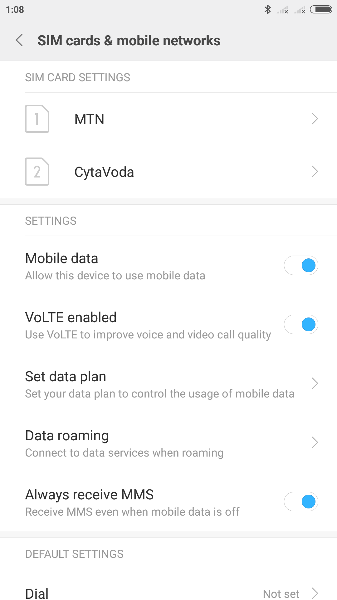

Same with me. Flashed all the romsbut nothing.sims are recognized but no signal.
