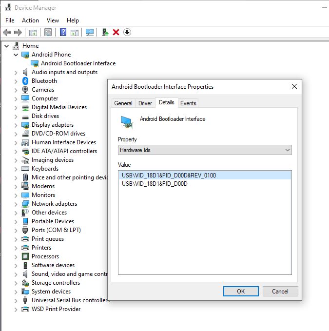

Hey guys,
I think I found the solution with a Windows registry hack, but I need the correct vid and pid values to be able to try it.
Can someone please check the vid and pid values and share them here?

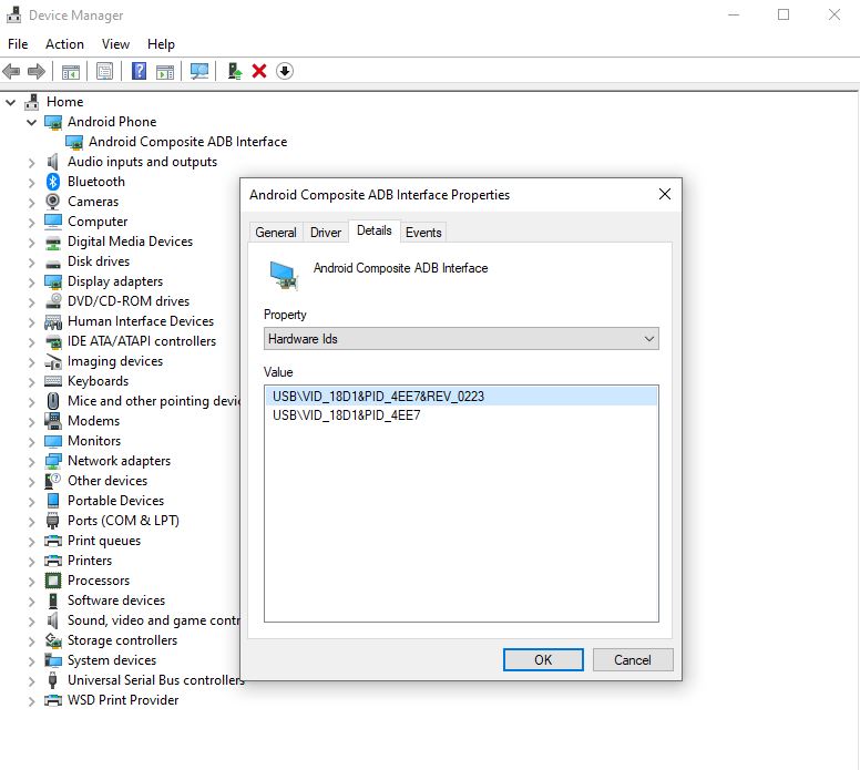

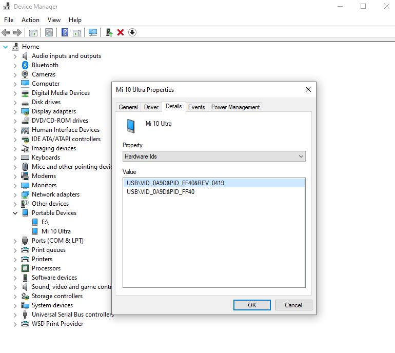

Hi, here are the 3 different IDs. Normal booted system, recovery and fastboot as they all show as different items in Windows. See attached screenshots.
Reactions: Mituga1
