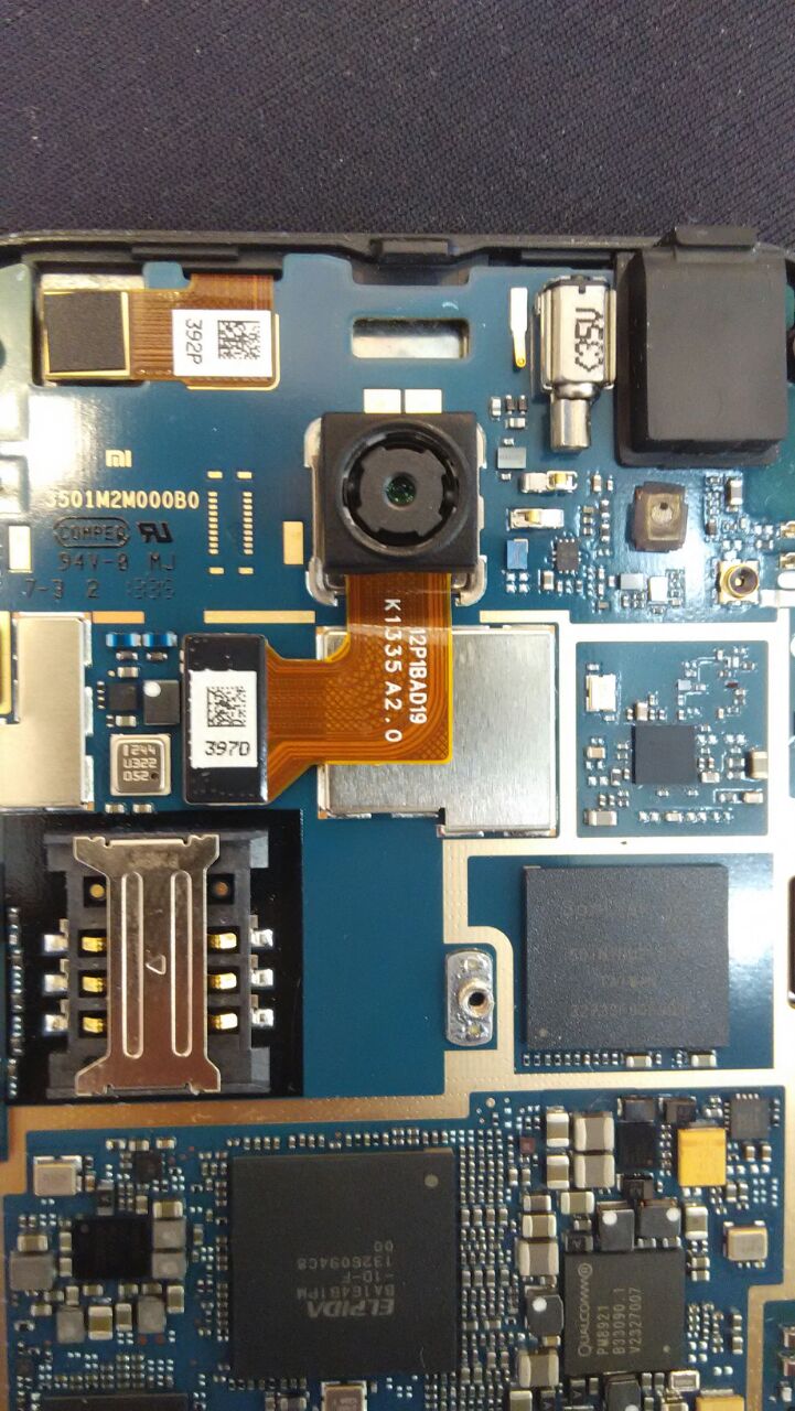

#13
Problem solved. Working camera.
The rubber hood was actually inside the appliance
Thanks to those who helped with the tips
in the photo below gives to clearly see the rubber on the site where engages the camera module

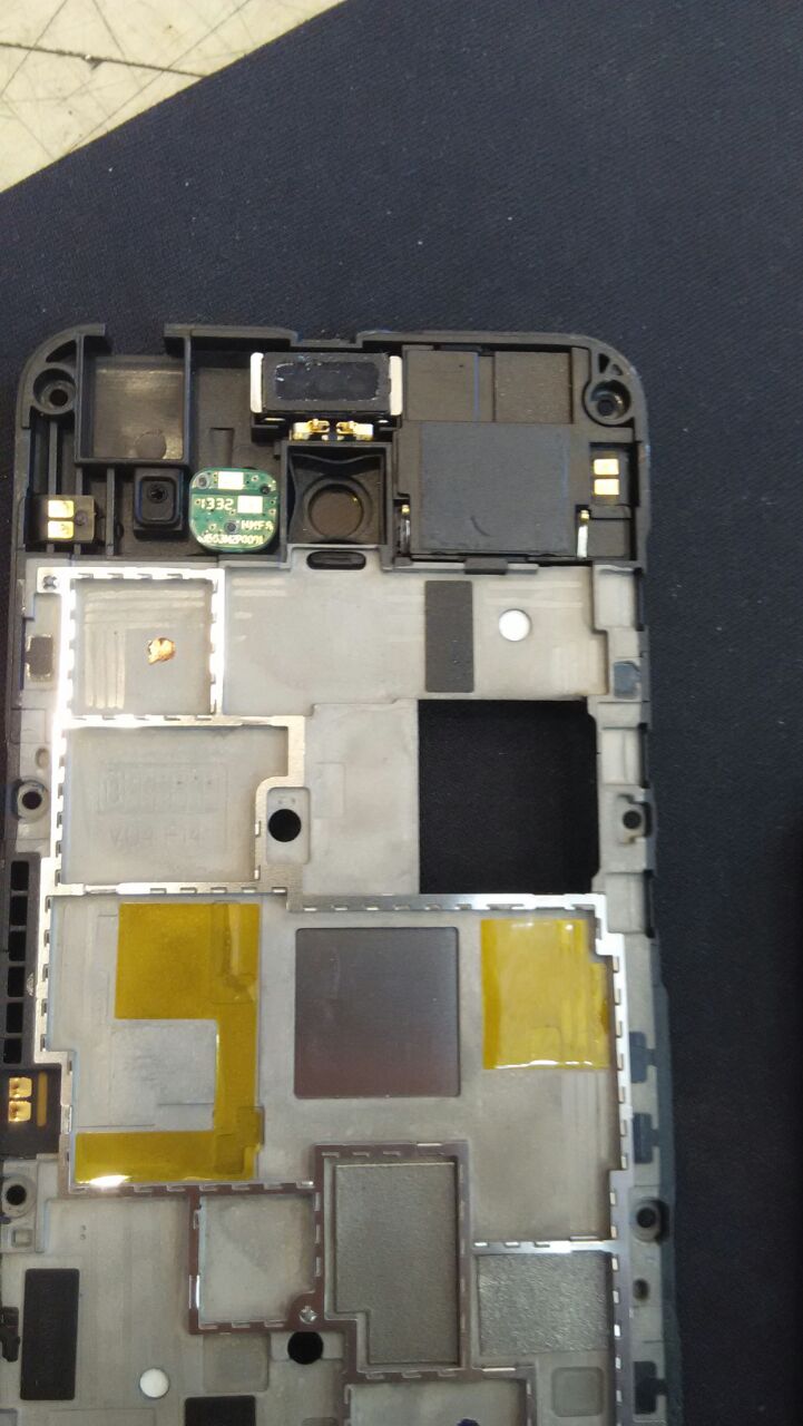

#15
Does anyone have any idea of how to proceed with LEDs?
LEDs are part of the screen or are on the mobo?
If part of the screen, I not have hopes of fixing
Jun 8, 2013
161
30
#16
Edited!!
Its part of the mobo!!
Great news about screen!
The blank rectangle is where led contact from mobo to screen.
Likes: Mleo
Mleo
Oct 19, 2013
47
6
#17
Thank U.
Tomorrow I will reopen my device, must have something blocking the light from the LED.
Probably should be an acrylic rectangle, and an anti-scratch protection should not have been removed
Mleo
Oct 19, 2013
47
6
#18
Problem solved!
On the back of this white plastic piece, shown in the photo above, there is a small "hole". The glass in front of the screen is painted with black ink. the "little hole" was also painted.
Using the tip of a metal clips removed the painting. I mounted again and the LED works perfect.
Thanks to forum users my Mi2S is almost like new.
Mleo
Oct 19, 2013
47
6
#20
good morning.
Yes, you must remove the rubber.
Before mounting the back cover again, put the rubber cover over the camera module
Sep 14, 2013
17
1
#24
The problem is, when you put the cover with the rubber, it was wrong. But if you put the rubber on the camera module before put the cover, everything is ok
Mleo
Oct 19, 2013
47
6
#25
exactly.
If you mount the device without removing the rubber camera module socket, the distance between the lens and the glass will be higher.
