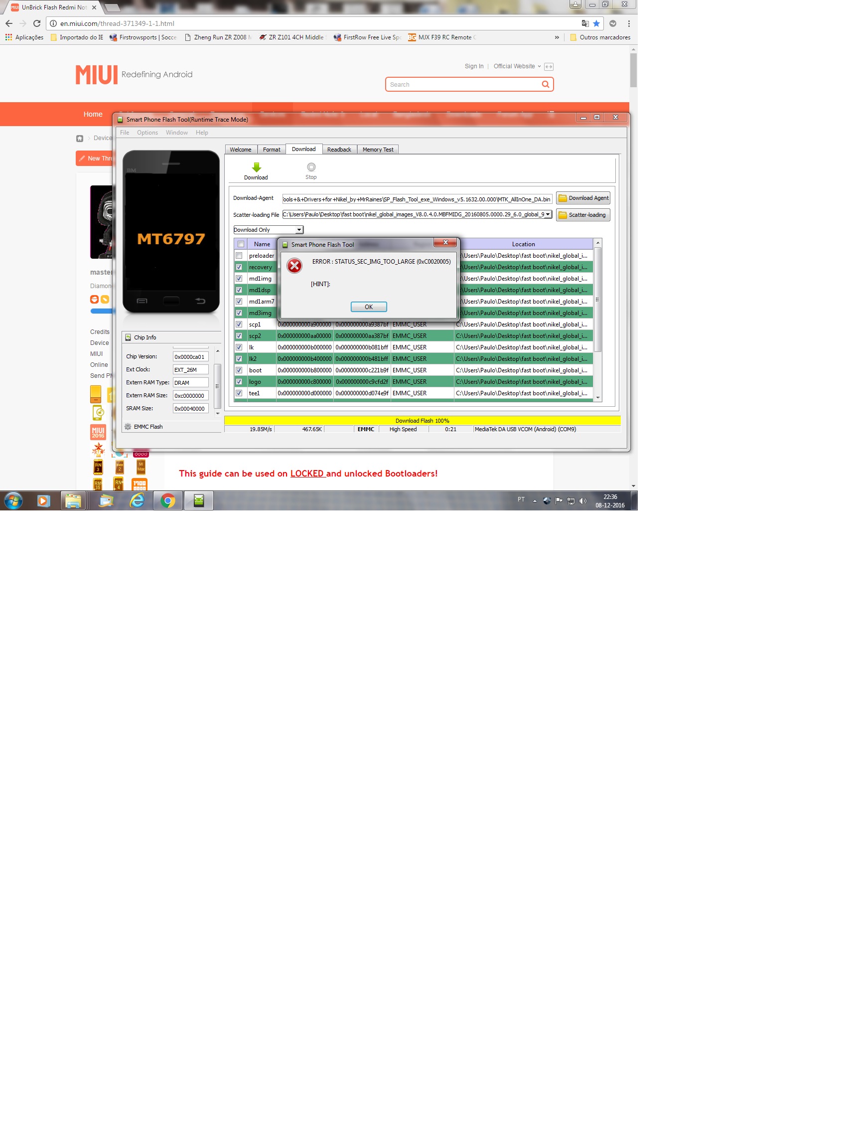

    Hello, I already expose a problem with my redmi note 4 and following your help I decided to flash the rom. The problem is that it gives an error during the process.
    Someone can help solve this problem.

    I used that tutorial and it worked for me, also in Win7. The only difference is that I used global stable 8.0.4.0. Are you replacing the cust.img file as it says?

    when all attempts failed :) try this method....
    http://en.miui.com/thread-410039-1-1.html

    this:
    "Download Official Fastboot ROM (China Dev, China Stable, Global - whatever you'd like) from here:
    http://en.miui.com/a-234.html
    And extract it.
    Download edited cust.img
    Please reply to view this thread.
    And overwrite original cust.img inside just extracted Official fasboot ROM, images' folder.
    This image partition contains only Local info and local apps."
    from this site:
    http://en.miui.com/thread-371349-1-1.html

    11
    Male
    What I do not understand is where I'll get the cust.img file to replace it. I only have what's in the rom that I did the download ...
    Is the first time I try to do something with the mobile phone and I can not quite understand what I have to do with the cust.img file.
    How do I replace cust.img file ???
    If they can be more specific, I thank you.
    thank you

    hello,
    problem solved, it works many thanks for your replays.
