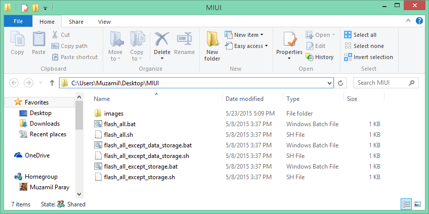

I had MTK phones up to this one, which seems more difficult to mess around with.
I had trouble as well, it was because I had not opened up the file I was flashing correctly, must be as thumbnail
you have to use the file in Muz's thread Global Stable (V7.1.8.0)
after installing this the phone updated to the latest version 7.2.3.0 ota
Must admit at one stage thought I would end up bricking it.
Thank you for your answer. I did manage to flash using the Muz method. Worked like a charm when I tried from a Windows 10 installation.
Now I am on 7.2.4 global but really want to change the locale to Denmark. So I guess I will ned another flash.
