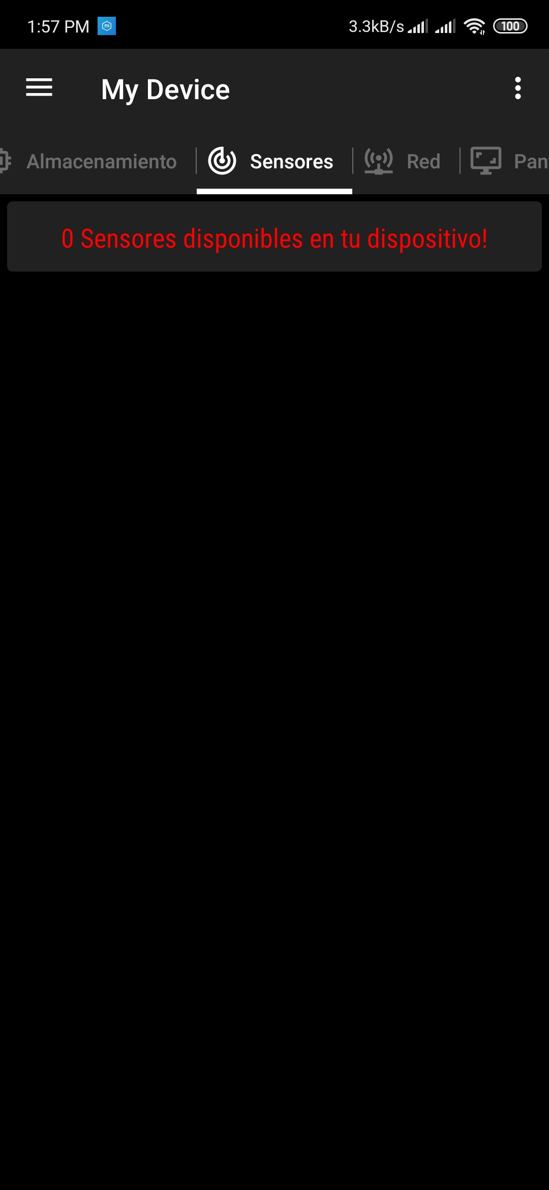

About 3 days ago I installed Xiaomi.eu (11.0.6), and today I realized that I had removed the gyroscope and proximity sensors or at least it did not detect me, since I installed an application and none of the previous 2 recognize me , I realized when I wanted to watch a video on YouTube, when I wanted to leave a video and it came out horizontal, never vertical, just like the proximity sensor when I make calls.
Do you have any solution.
