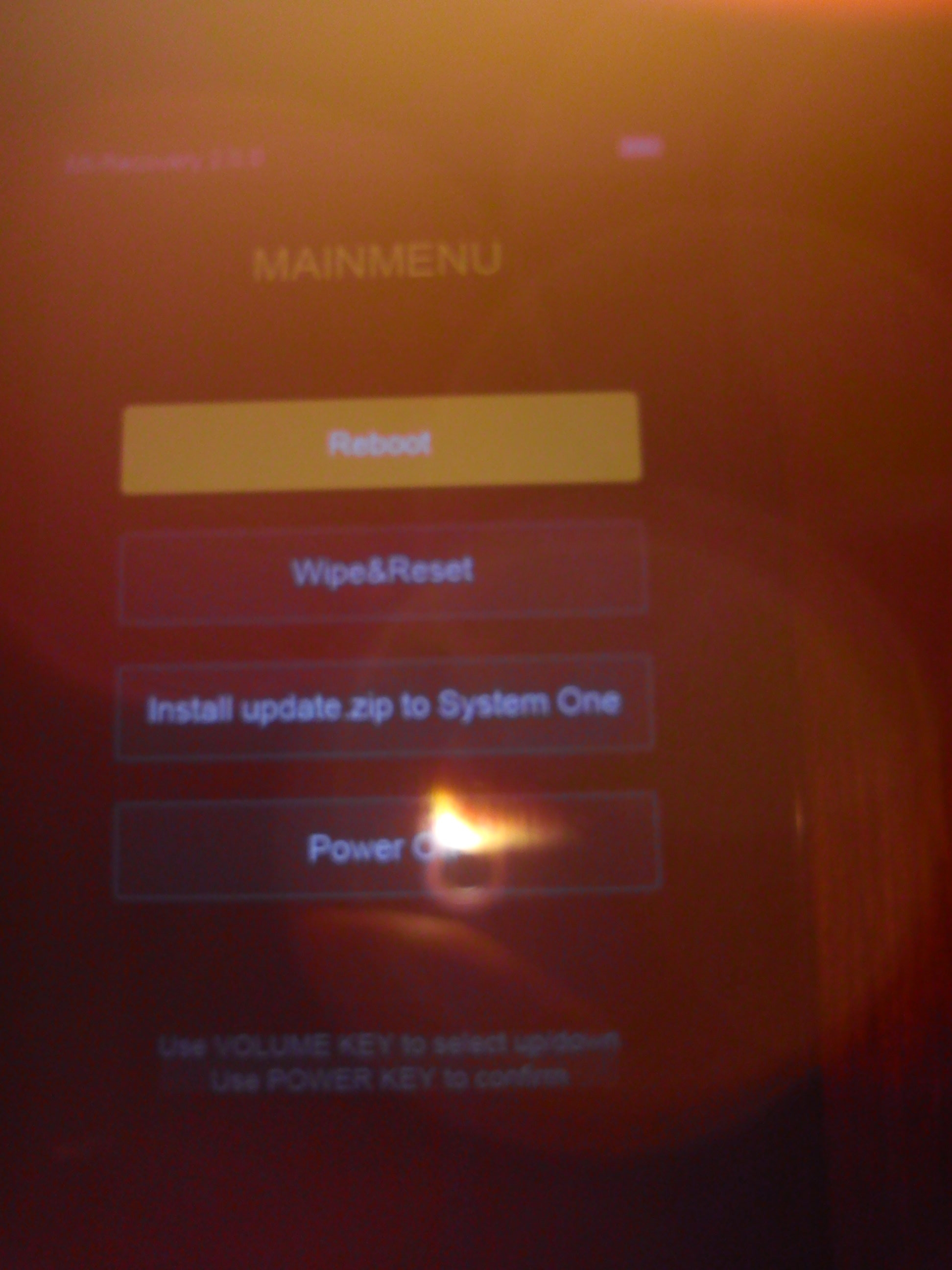

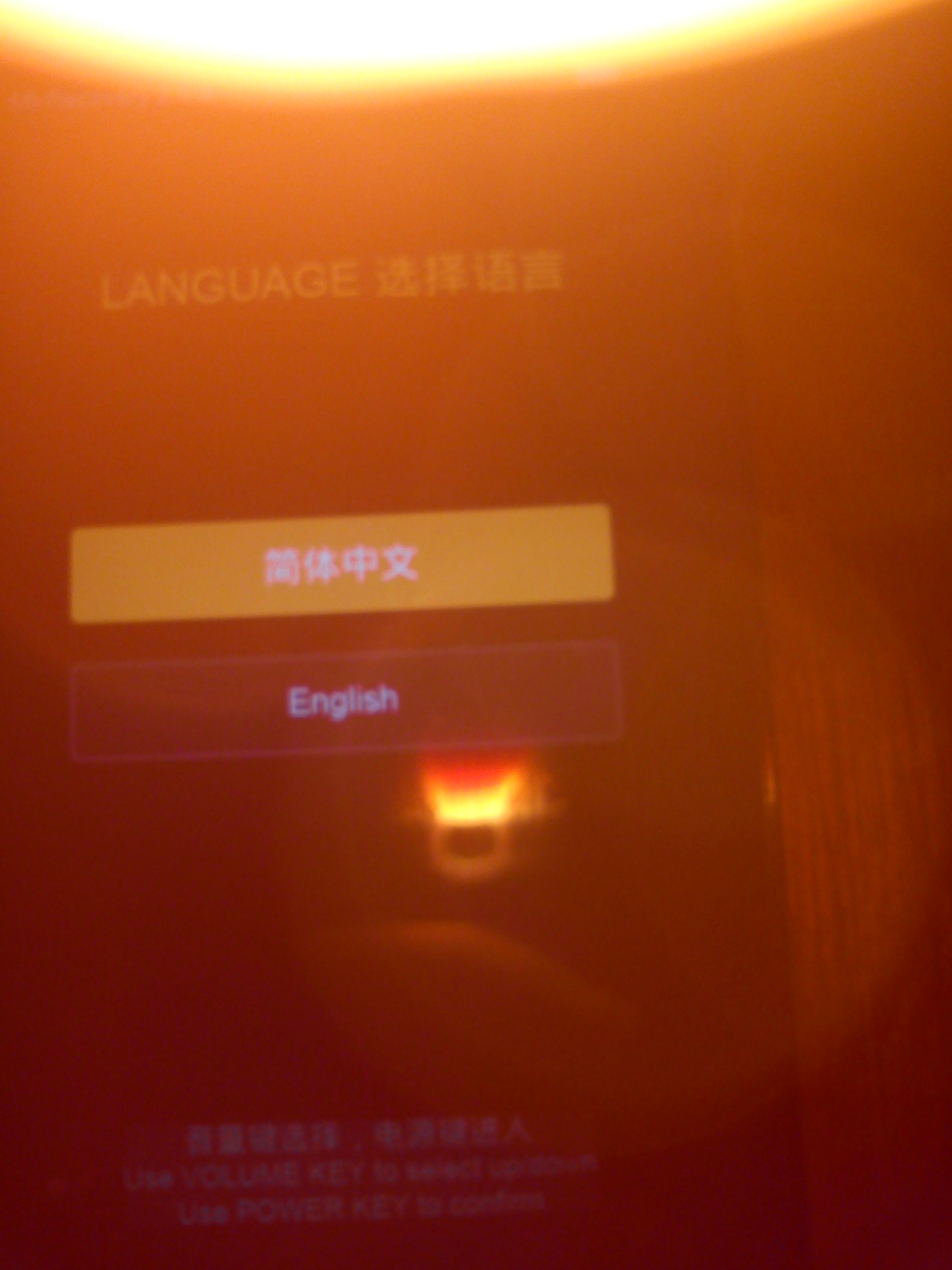

Jul 24, 2011
465
234
65
#6
Fake Mi2's are int he wild. search up on youtube. This is what recovery should look like on a original Mi2

#8
hopefully you do. that is a better fake then the one in the vid i found. Just by looking at the one in the vid i posted you can tell it's fake. your however looks exactly like mine only difference tell is the recovery and the imei. If you get money back this is a good place to get it got mine there and it's 100% original Mi2
