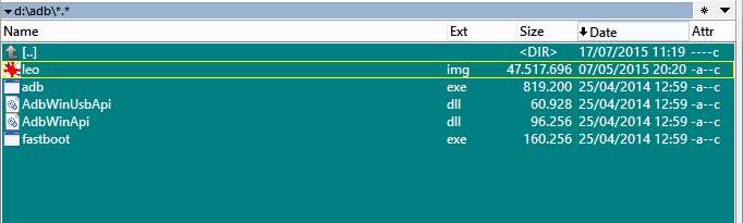

    3. Extract adb.rar to a folder (it will create c:\adb). Inside you will find the TWRP Recovery leo.img .This you will need it, as you will work under dos and sometimes doesn't understand well big names. Copy the rom from your pc to the root of the mobile. This is what you should see now

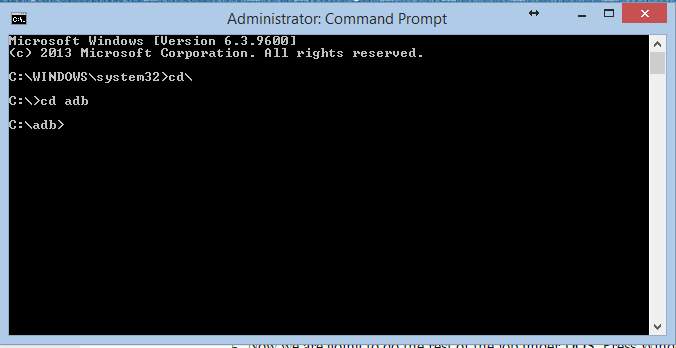

    5. Now we are going to do the rest of the job under DOS. Press Windows Key + X . From the menu appeared, choose Coomand Prompt (Admin). When the DOS open, we write cd\ and cd adb as shown.

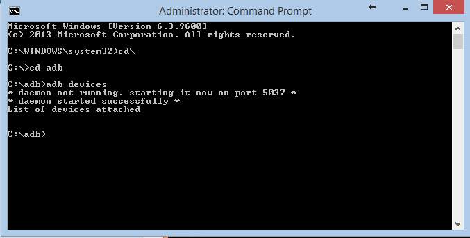

    6. Now We connect our mobile with the pc through USB. At the DOS window we write adb devices
    Now our device is connected with the pc. We type adb reboot bootloader
    The device reboots in Fastboot mode (we see MIUI MITU)
    After that we type fastboot boot leo.img
    By this way we install temporally TWRP in our device and by this way we can install any rom we like. You will see a new menu will appear. From there choose install, find the rom and swipe to flash. The procedure will start and you will have your ROM installed.
