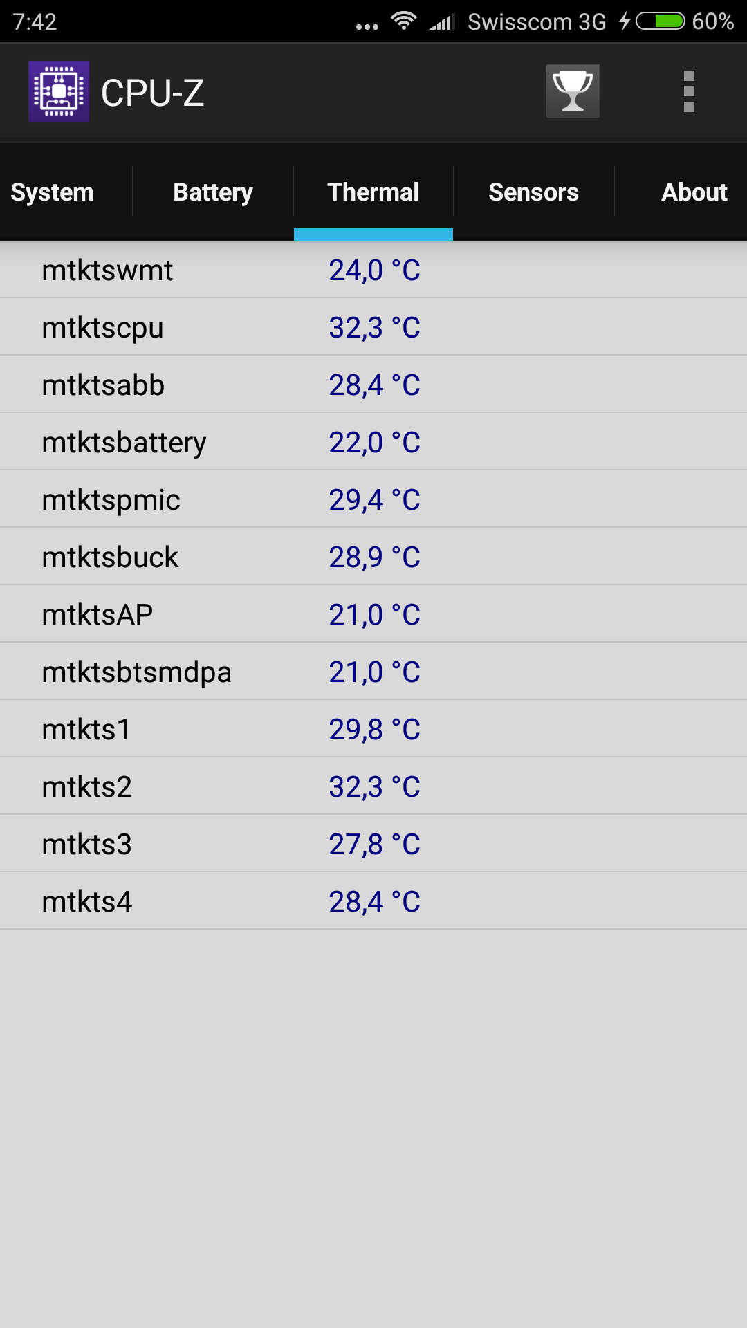

    Temperatures

  13. Jesus Rebaza
    Jan 30, 2016
    11
    1
    Male
    Wow so my system is totally overheating thats why it keep rebooting (pretty sure is the thermal protection) what about the board and bootloader? (sorry for annoying you. Thanks so much for the picture)

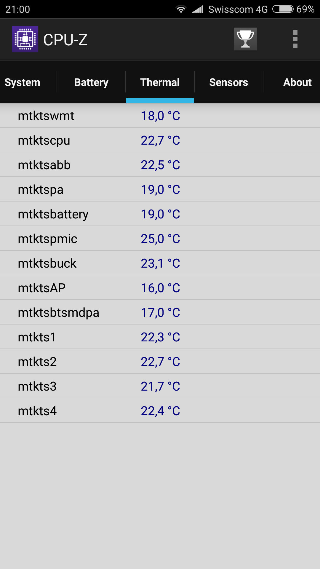

    Now the phone wont turn on. By the way, can you send me a picture of the temperatures when is connected to the charger, please.

  23. Stefano131270
    Oct 4, 2015
    2,997
    1,666
    322
    Male
    Switzerland
    Hi, now the phone is charging, the temperatures remain low
  24. Jesus Rebaza
    Jan 30, 2016
    11
    1
    Male
    Thanks, Now i know that the board is shorting so i dont think is the screen or the battery. I'll take the phone to a technician hopefully is repairable.
