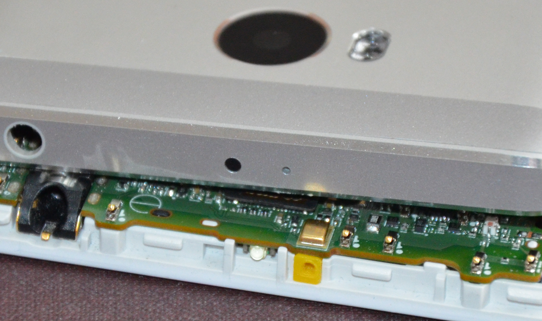

take a look on the secondary mic (next to IR sensor), probably you have moved it and now noise suppression is too high.
thanks, but i have no idea where the 2nd mic is. top or bottom?
possibly the smallest whole at the top?
those colored ones?

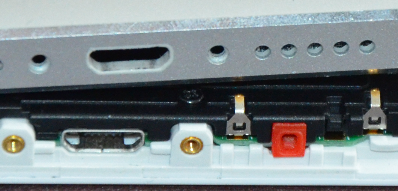

i took them out but cant see that would be placed wrong.

You can try to cover the hole of the one on top and make a phone call to see if the problem is about the noise cancellation mic...
other than that I've no ideas... I'm sorry....:(
