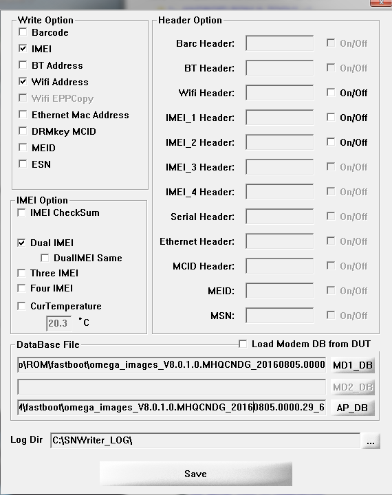

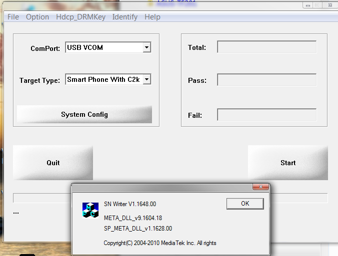

I successfully restored my IMEI & Wifi MAC altogether using the latest version of SN Write v1.1648. All the other version of SN Write doesn't work. It seems to be more user friendly with SN Writer if it works for you. Both IMEI & Wifi fixed PERMANENTLY. I got the problem when I did a bad flash using MTK-Flashtool, my Redmi Pro was unlocked and not rooted when I had the problem.

Have you tried with SN Write version 1.1648? Only this version works for me on my Redmi Pro. All the other are giving me error loading DB file. If you are not getting error loading the DB file, be patient, it takes 5~10min to complete. I only check to update IMEI and Wifi MAC
I use SP flash to re-flash an old version of the Chinese stable official ROM v8.0.1.0 and use the DB files from that version in SN Writer. Remember to use SN Writer v1.1648

Thank you very much JRedmi!!
Finally I did with your method.
I tried with Maui Meta but didn´t work because gives my error loading the DB file. I did flash again with format and download and then use SN Writer v.1648, how you said, and the I got to repair imei.
