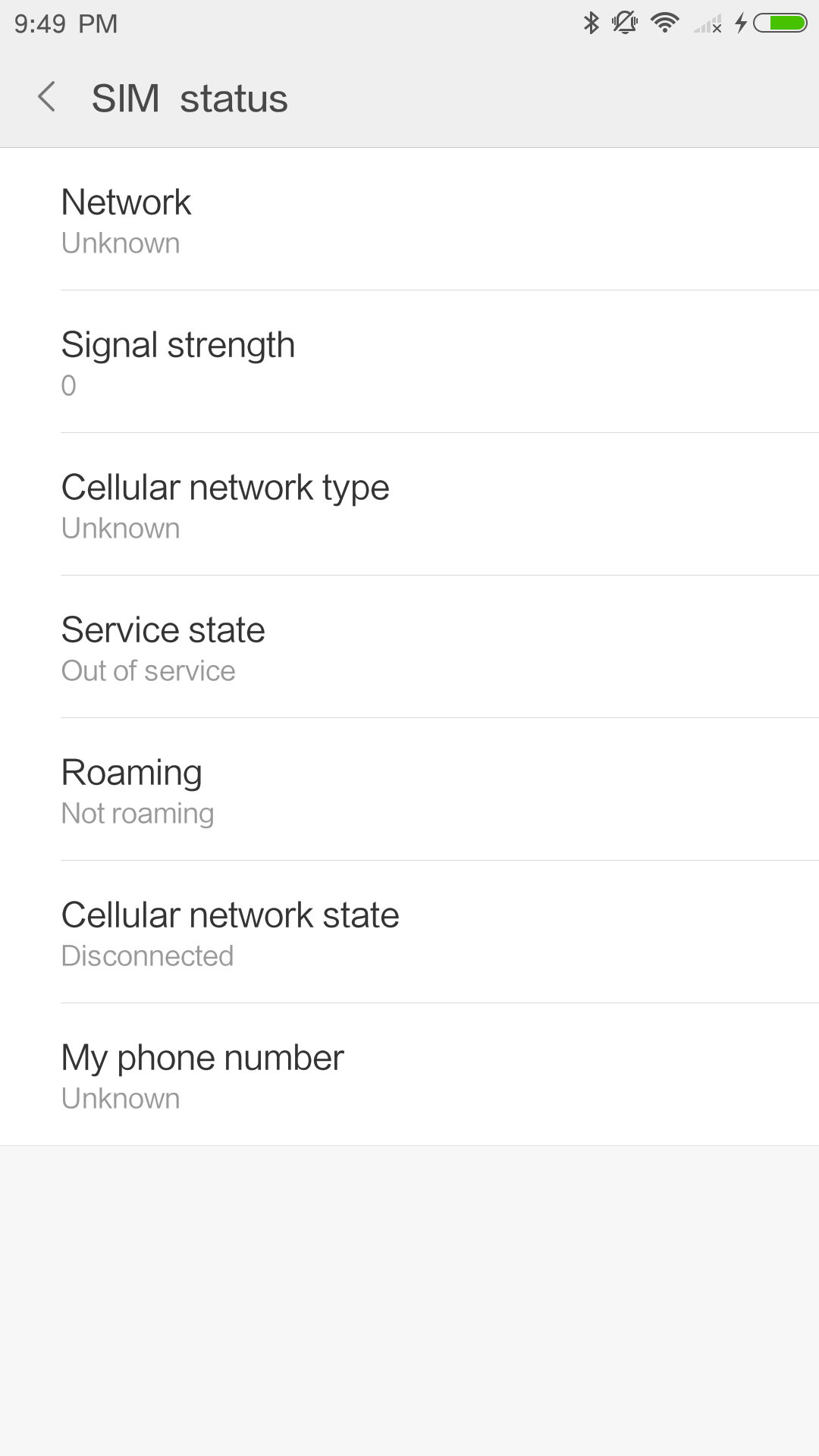

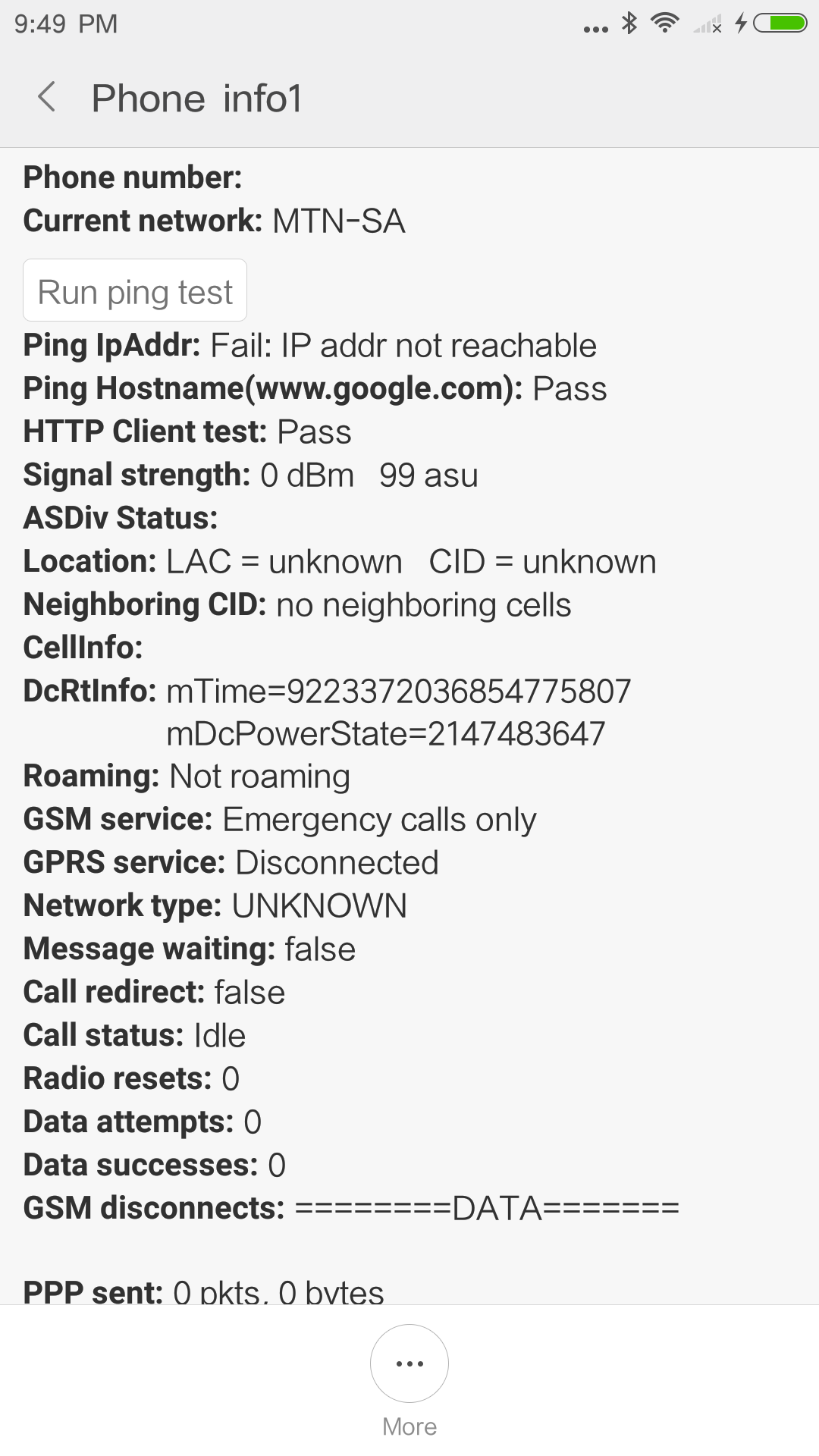

Dear Community,
I have a big problem with my Redmi Pro.
I have absolutly no connection to the network provicer.
First I try to explain how it came.
I have a micro Sim of provider a and another micro sim of provider b.
It was running great with the sim of provider a but I wanted to insert the sim of provider b.
After I done so I wondered why I have no connection. Setting back the sim of provider a in, and I wondered why I have no connection too.
both sim cards work in other phones (nexus 5) I have no idea.
I flashed the developer fastboot rom in hope to solve it but nothing happend.
there are workarounds for other mobiles by flashing NON-HLOS.bin but in the fastboot of the Redmi Pro there is no NON-HLOS.bin.
The Baseband is correct and he recognizes the sim card but says "No Service"
I hope you can help out
