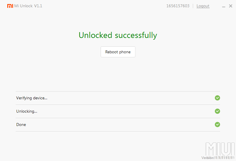

@Pumpino and other unfortunate owners of a Xiaomi Redmi Note 3 Pro Special Edition. [kate]
Follow the instructions by RedmiPac/blackpac and you should be able to unlock officially.
Do not follow other guides or FAQs from MIUI official forum.
It will not work unless you are able to add account and device under "Mi Unlock status".
I had been trying since october last year. Check this thread and attached pic and you can see that it worked:

For those of you who are stuck on 50% Couldn't verify device - ''Current account is different from the account info on the device''
I would stongley advise to flash recovery and do nandroid backup before you proceed in case of bootloops, IMEI lose etc...
Don't forget to backup your data!!!
Files you'll need
* MiFlash 2016.08.30.0
api.bbs.miui. com/url/MiFlash
* ROM File: kate_global_images_6.7.14_20160629.0000.25_6.0_global_1b43c8f07f.tgz
bigota.d.miui. com/6.7.14/kate_global_images_6.7.14_20160629.0000.25_6.0_global_1b43c8f07f.tgz
* Mi Unlock Tool v1.1
en.miui. com/thread-221493-1-1.html
(remove spaces, can't insert urls)
1. flash kate_global_images_6.7.14_20160629.0000.25_6.0_global_1b43c8f07f using MiFlash 2016.08.30.0
2. reboot device
3. hard reset the device Settings>Additional Settings>Backup & Reset>Factory Data Reset>Reset Phone
4. cleanboot the device
5. setup your Mi Account (I used mobile number)
6. go to Settings>About phone and tap on "MIUI Version" 7 times to enable "Developer Options"
7. go to Settings>Additional Settings>Developer Options, enable "OEM unlocking" and "USB Debugging"
8. connect device to the computer and authorize USB Debugging on the device
9. disconnect device from Computer
10. login to i.mi.com (I used mobile number)
11. find device
12. power off the device
13. boot the device into fasboot mode - hold volume down+power
14. login Mi Unlock v1.1 (I used mobile number)
15. connect the phone to computer
16. proceed with UNLOCK
Please report back if it worked...
