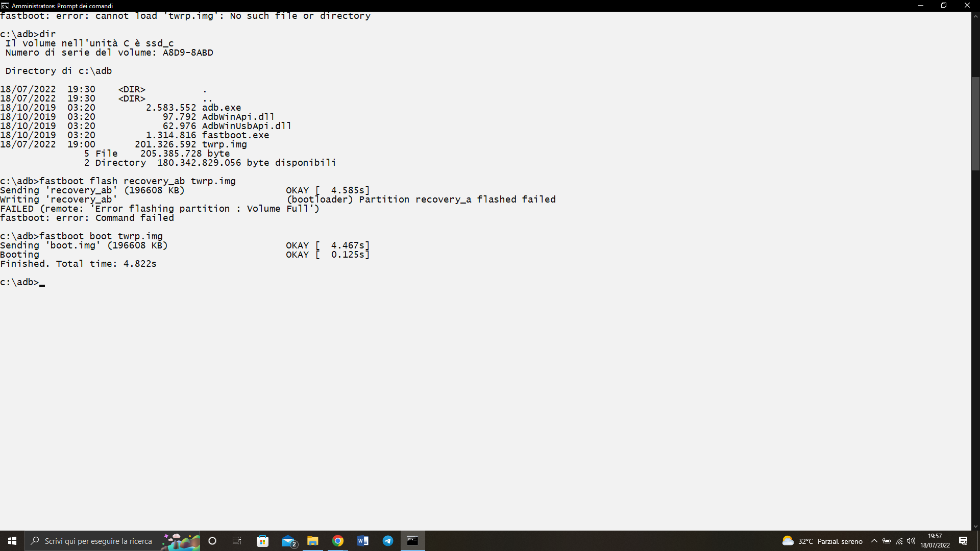

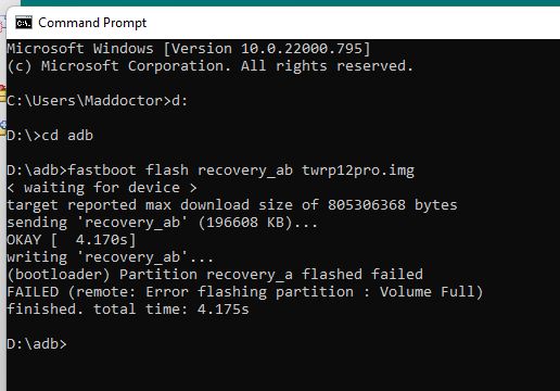

zeus and cupid have a recovery partition. You can flash it there directly to have it persist across ROM updates...
Code:
fastboot flash recovery_ab twrp.img
When I try flashing with this command I get an error, that the volume is full.
That might be the wrong TWRP then. There are "boot" and "recovery" variants.
"[REC]3.6.2_12-Mi12Pro_v3.8.3_A12-zeus-skkk_89dedb57.img" is what you need.
Yes I saw it and at changelog says : Fixed some installation failures on virtual A/B devices (If failed, try Advanced > Merge Snapshots)
So this could solve my problem. Will check it tomorrow

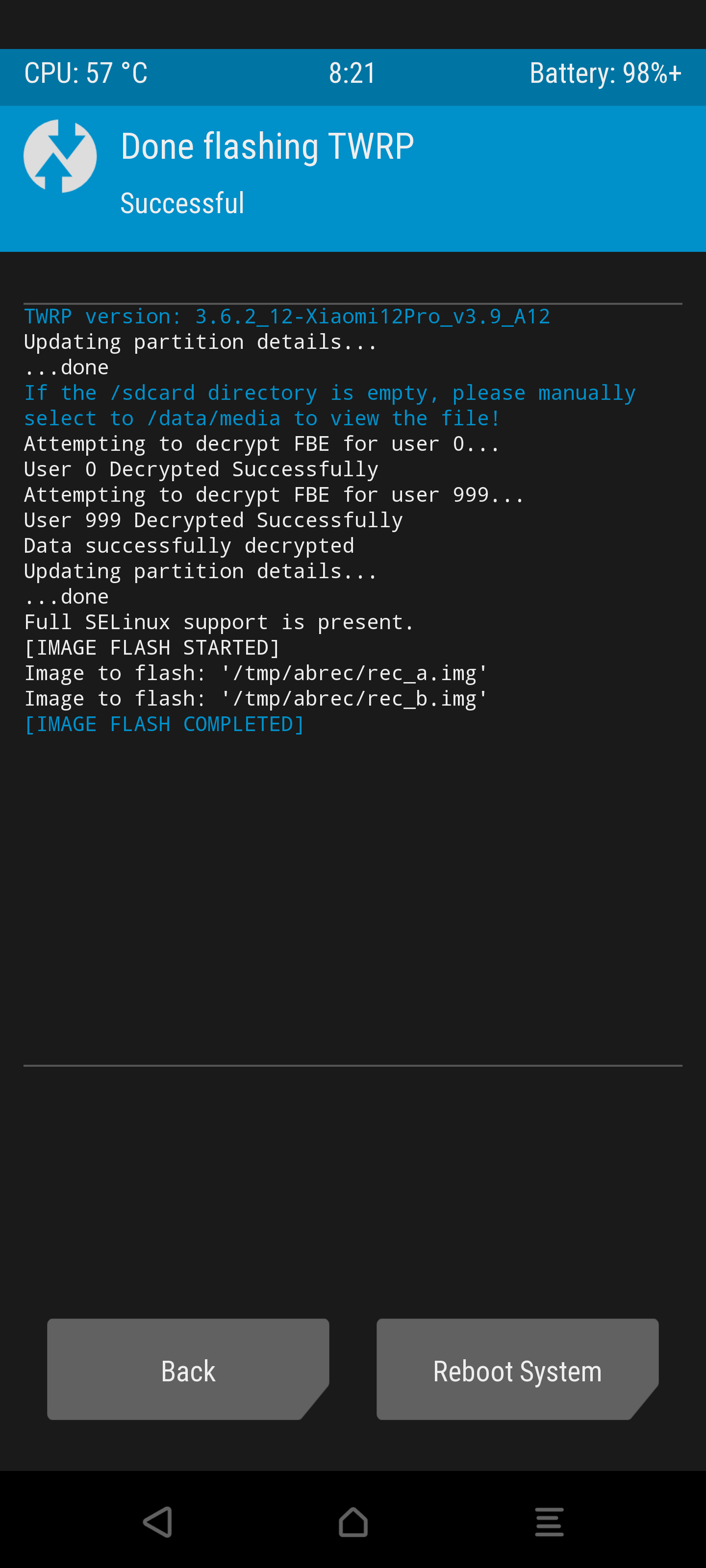

Mission completed!
