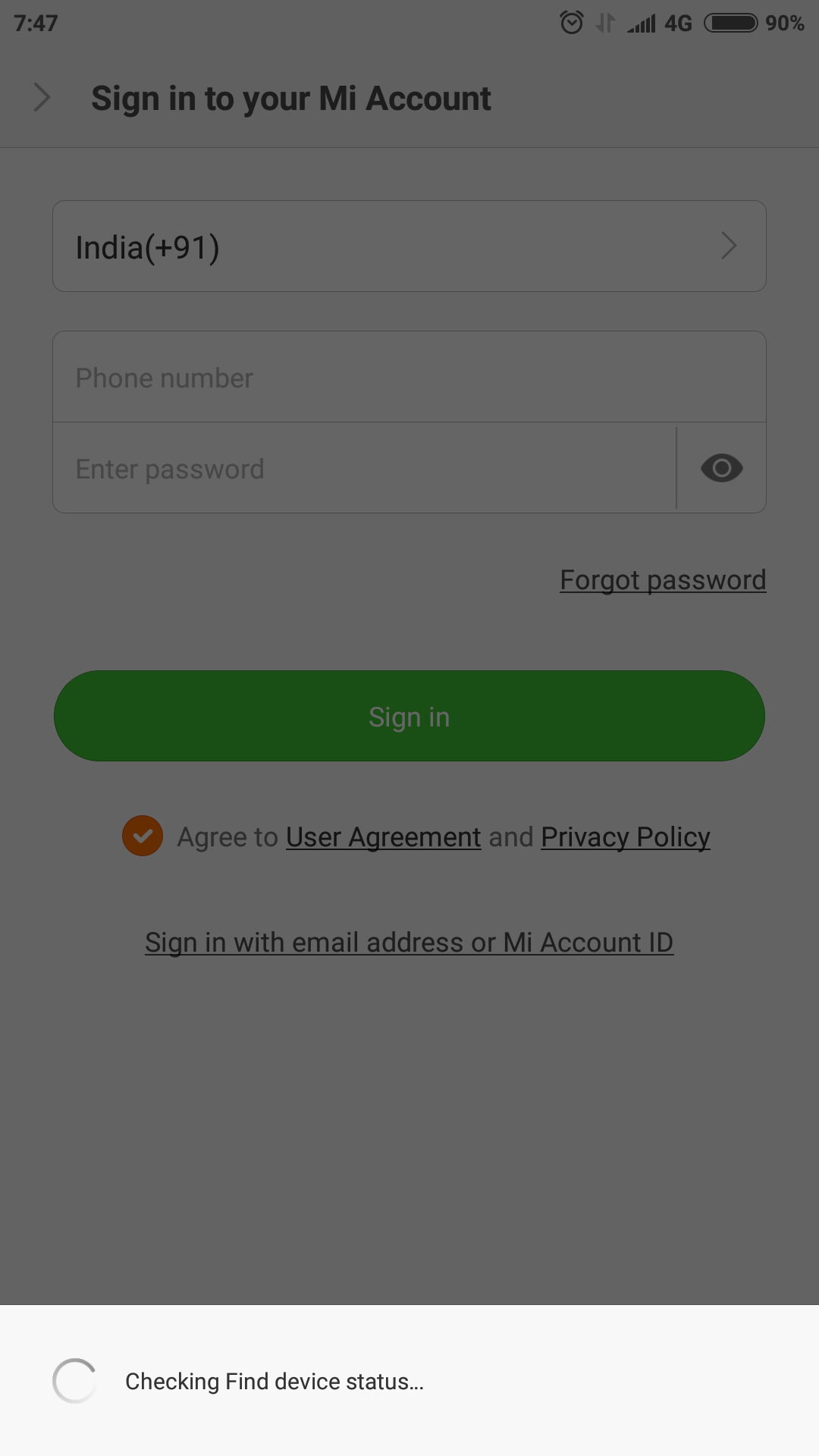

I can't sign in to my mi account because of this, and this is not the only issue - the device is seriously lagging. The screen freezes every few seconds even now as I am writing this text.
I flashed 6.2.18 using sp flashtool since my bootloader is still locked. I had the same issues when updated to 6.1.29 so I just rolled back to 6.1.21 but it's very annoying to restore all my data every time..
I don't see anyone having these issues so what is so special about my Redmi Note 3?
thoughts anyone?

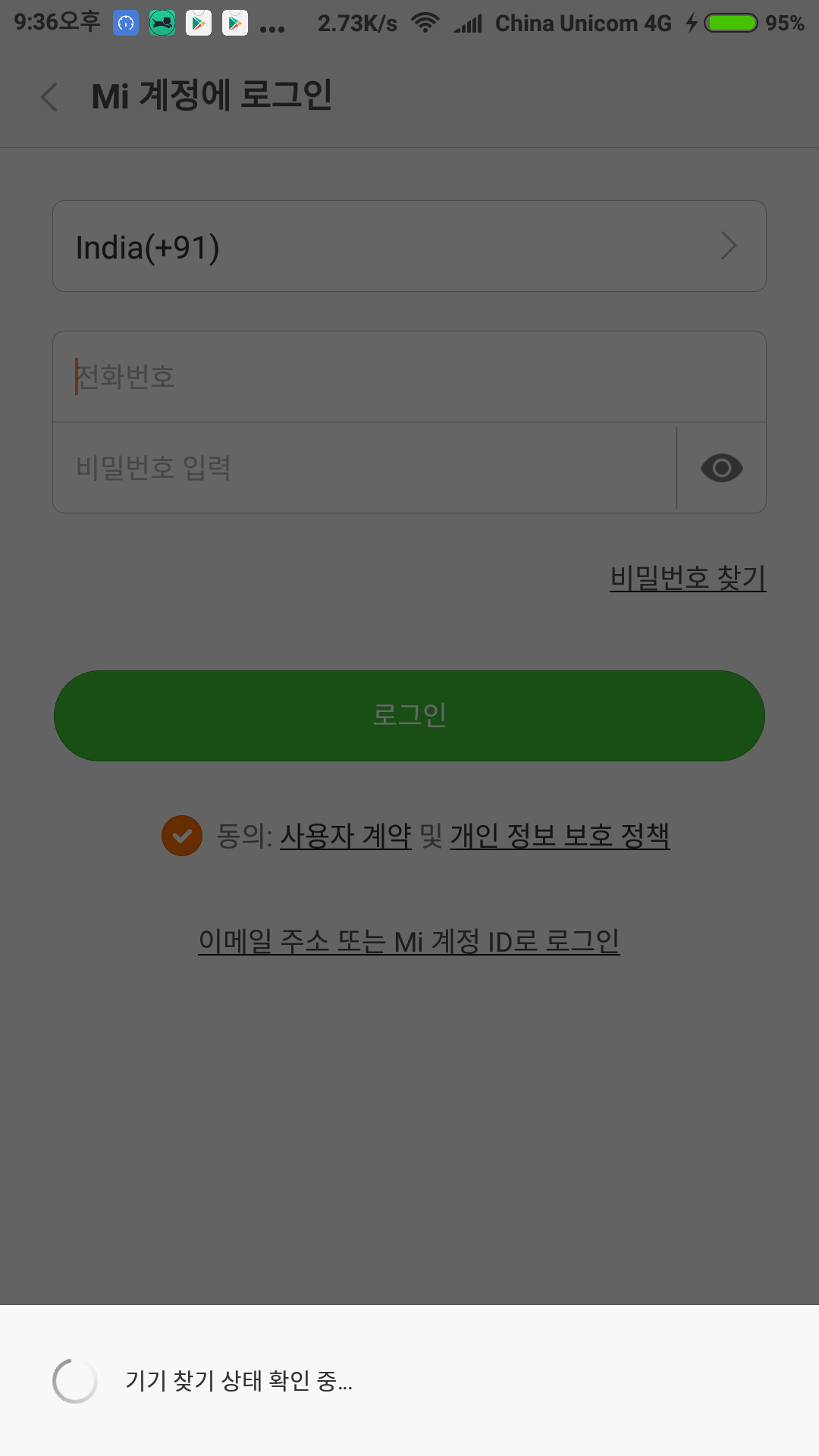

Have a same problem with this. I'm now living in Beijing, China, and also trying to log-in Mi account but also has a problem about "Checking Find Device Status...."
No one helped me with this issue, the only solution I found was to flash another rom (including wipe user data). It's annoying but the only thing that helped me. Both times it happened to me - the rom itself was defective and I had other issues such as lags as well..

I have exacty the same issue:
Updating from 5.11.21 to 6.4.16 or 6.4.22.
Is there any 6.xx version that wont have this issue?
EDIT#################
Also tested version 6.3.18 with the same result...
Currently the only solution is to flash an older Rom, 6.1.28 did the work for me.... and then update to the version you like, using the updated...

Hi, according to a discussion on miui forum:
The device check comes with the missing of the imei of your phone. This can happen if you flash with other options then "Download only".
Search google and miui forum with tag like REDMI NOTE 3 change Mac Address or Imei
After reboot phone, goto MI account, let it finish searching, then tap "Try again", and then you can input your account..
