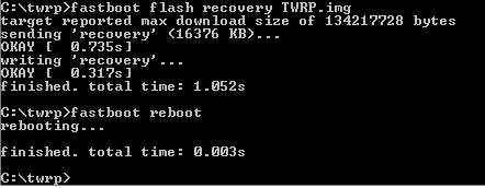

I also tried the other method
fastboot flash recovery xxx.img
and
fastboot reboot.
I had successful message. phone restated ok however no when I restart in Recovery mode I only see the Black Phone screen with insert USB cable image.
Any more ideas???

ok finally flashed Twrp with this method. http://en.miui.com/thread-203716-1-1.html and installed EU ROM however my GPS is still not working.
