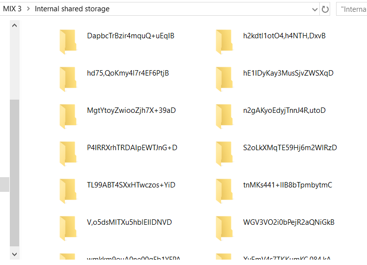

i have just flashed the Xiaomi EU Rom as descriped, everything boots fine, but now the internal storage is a complete mess when i try to access it on my PC (see picture), do you guys have any solution

I had this problem a couple times while I was in TWRP. It has something to do with encryption I think. You need to wipe data in TWRP to remove the encryption. It will obviously remove all your apps and stuff but that's the only way, I believe.

Tried Ponce at the first time I fresh the twrp. If you didn't backup you'll lose the data this time. Just format it and refresh the EU rom again
