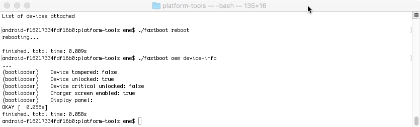

Please start by telling us what is the state of your device. What ROM version does it have, is it unlocked, what where you trying to do, can you access EDL... etc...
At this point if i turn on the device it freezes on the mi logo. I can boot into fastboot. i have tried to flash twrp recovery with no success.
I have tried to flash xiaomi s fastboot oficial developer image through the MIUI ROM Flashing Tool but it return the "missmatching image and device" error...? i am now downloading the stable image.
thank you so much!
.... Did you unlock your devices bootloader?
EDIT: What device are you actually using? 4, 4A or 4 Pro?
Still, what device are you using? 4/4A/4Pro? And can you post screenshot of what ''fastboot oem device-info'' comand outputs?
Redmi 4

Thats your problem right there. If you had used the official method for unlocking, you would have ''Device critical unlocked: true''. The method you used (unlock-go) doesnt actually unlock the bootloader completely, as it will later relock and or make your device brick itself. What you have to do now is try to enter EDL, and flash a official fastboot rom over it, this will clear your data and ''relock'' your bootloader. Then after youre on official ROM (China Dev, not stable) apply for unlocking the bootloader and use official Mi Unlock method to unlock it.
