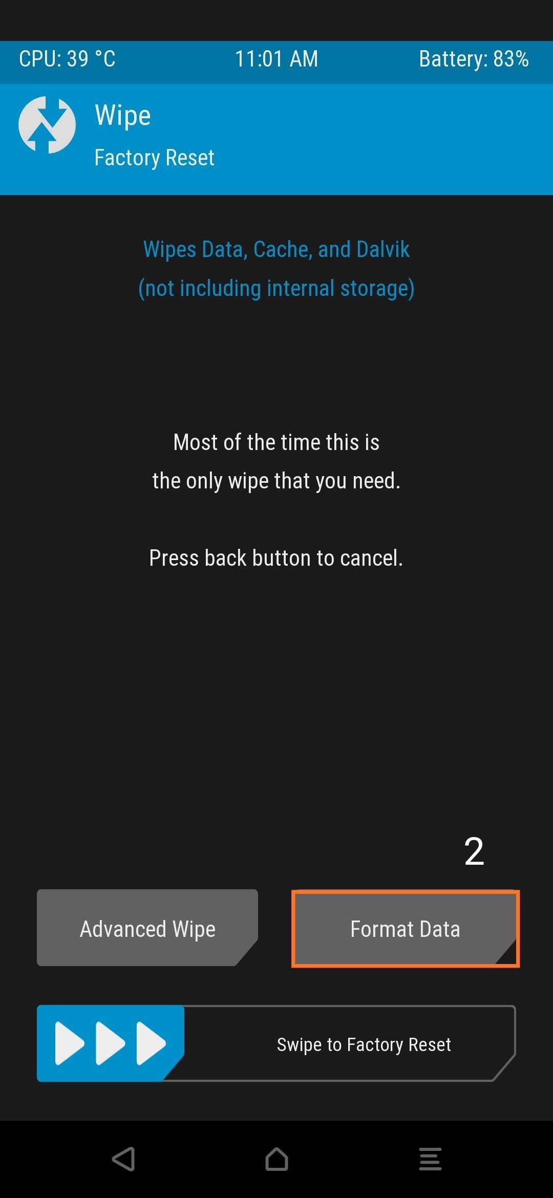

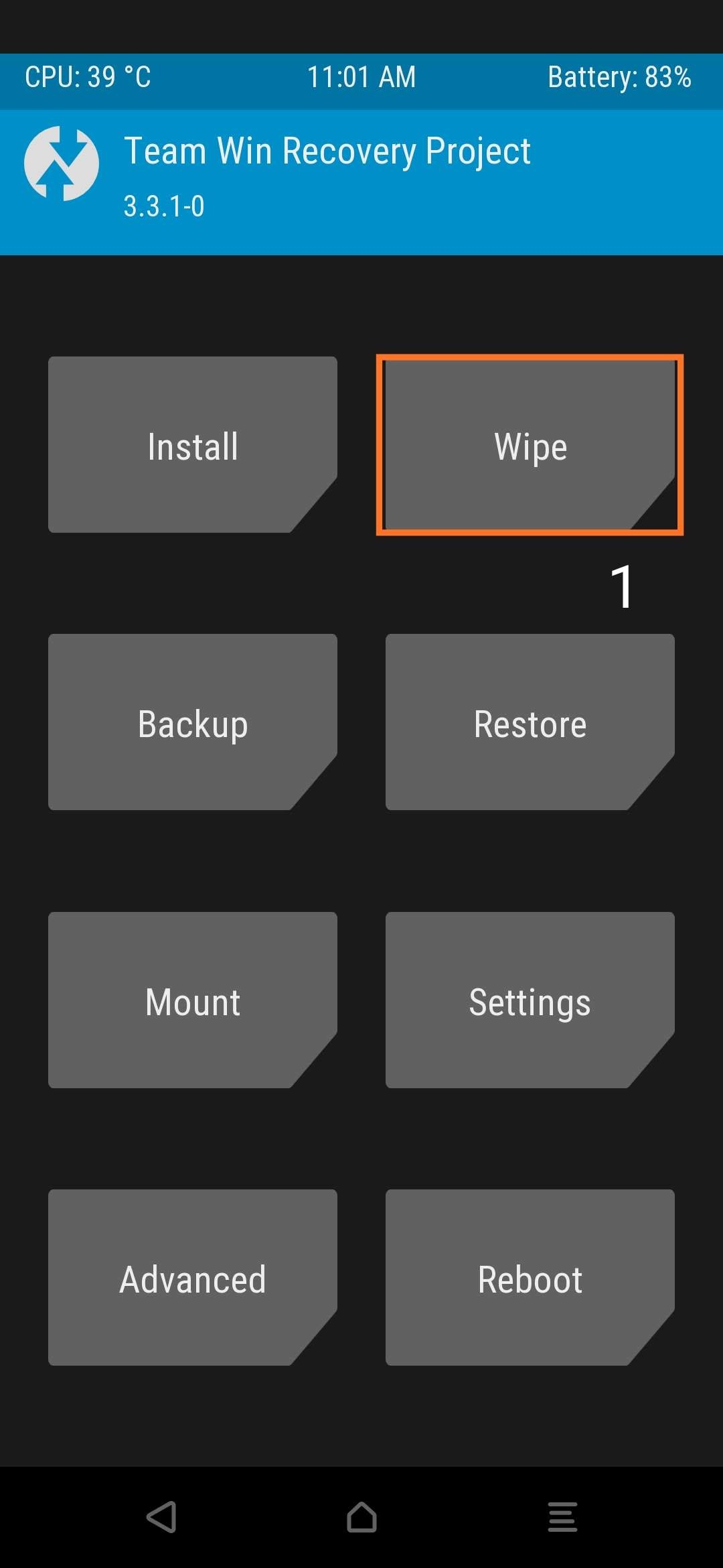

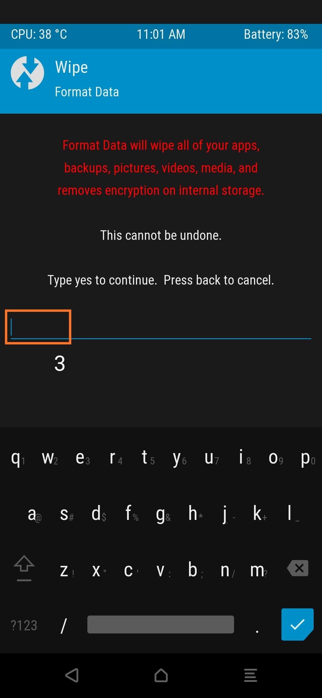

Every time you flash from stable to beta and vice versa, you have to format data in TWRP. You will lose everything.
