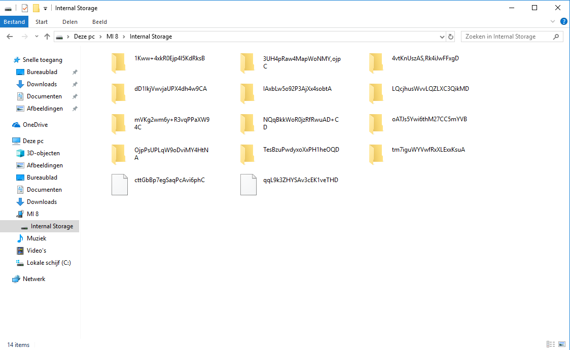

I'am trying to copy paste 8.9.13 into TWRP for install, but my internal storage on the Mi 8 looks like this https://ibb.co/k1QEmp but it wont let me copy paste my zip file. I'am stuck as my device cant be recognized by PC Suite and Mi flash.
What can i do?

you need to start twrp, choose wipe, wipe data and FORMAT DATA (type yes)
start / reboot twrp and you can copy your Mi8 Rom
MVP! Thank you sir, i downloaded the latest TWRP based on Android Pie and followed your instructions. :D
