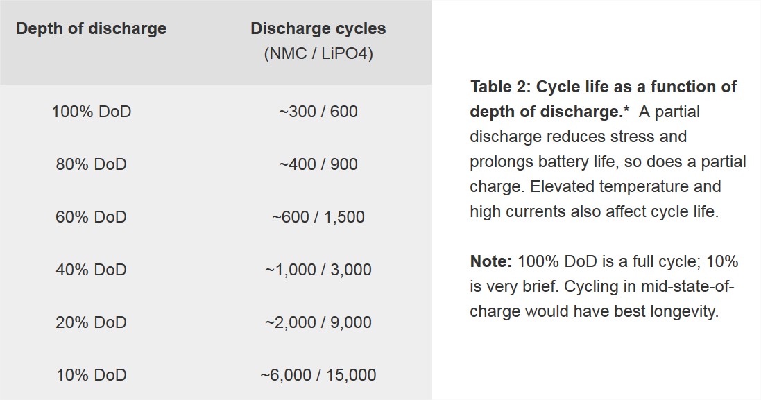

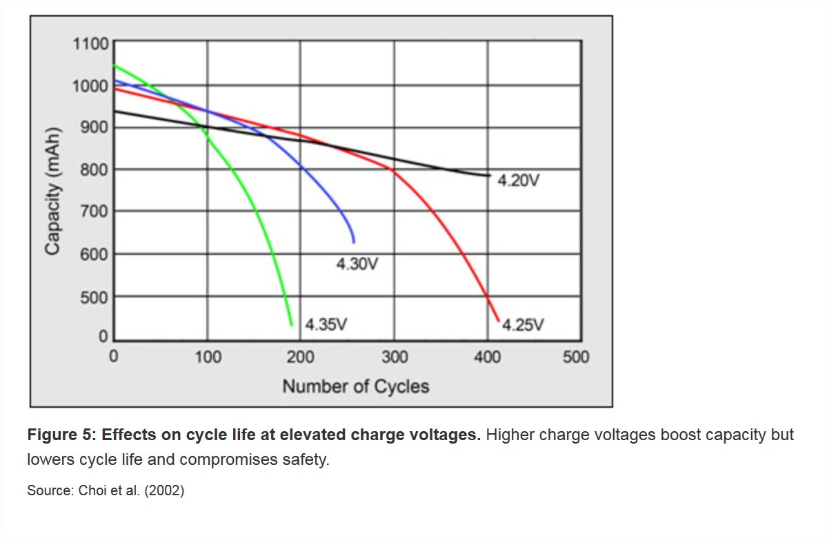

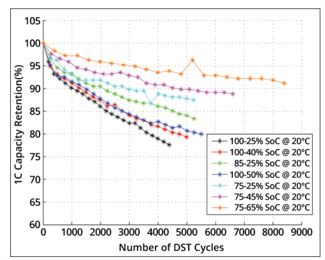

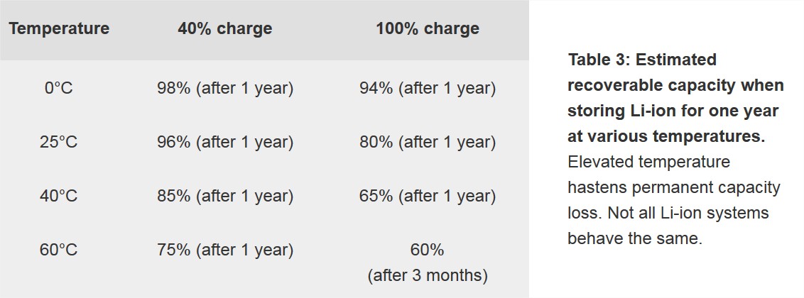

there the paper about charge influence on battery:
https://batteryuniversity.com/learn/article/how_to_prolong_lithium_based_batteries
