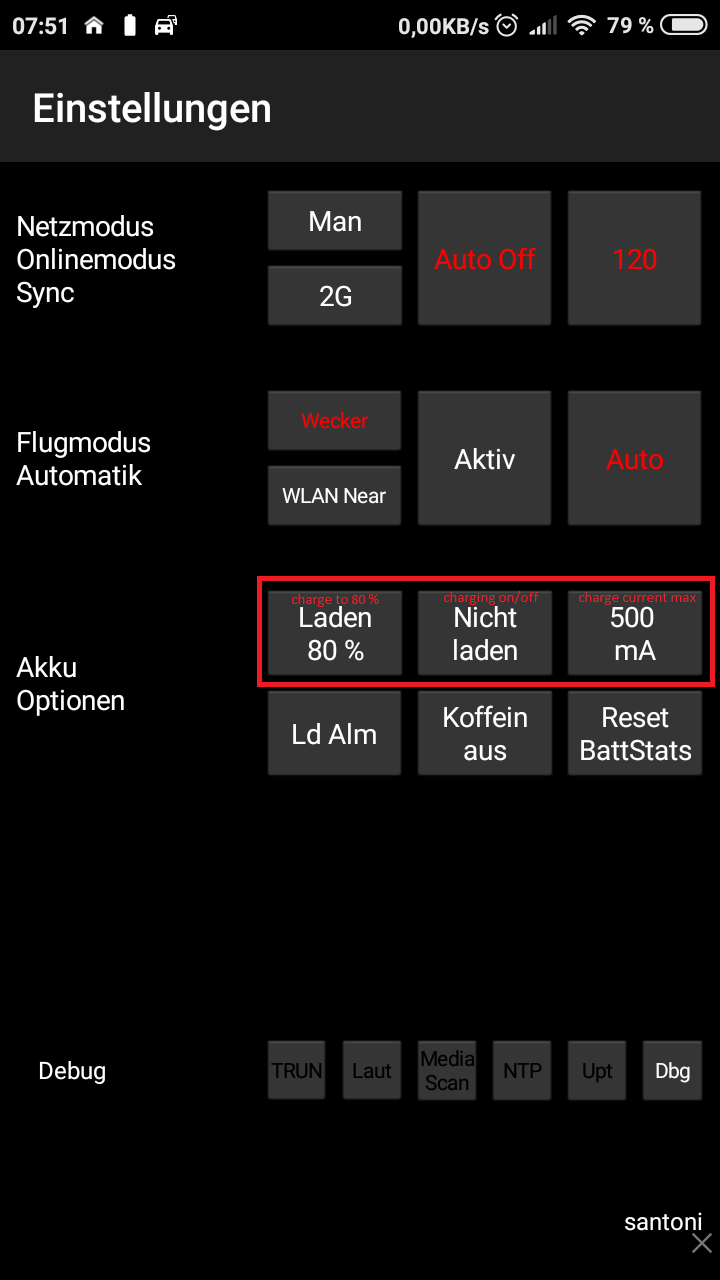

At the moment I charge my santoni's battery like this:
  • Plug in charger in the evening with charging disabled (echo "0" > /sys/class/power_supply/battery/battery_charging_enabled).
  • Tasker enables charging when the calculated time (needed to complete charging until the next morning) is reached (echo "1" (...)). Charging with only 500 mA, so no warming at all.
  • At 80 % Tasker disables charging again.
Works like a charm. Of course it needs root, but for me an Android phone without root is not usable anyway.

- to limit charge current to 500mA you just use a charger with such output right ?
No, it is charger-independent. I can limit the maximum charge current by writing the value (I think it is in µA) to /sys/class/power_supply/battery/constant_charge_current_max.
- I have Mi8 running latest xiaomi.eu ROM but not rooted because I've read magisk could cause some problems... did you experience any problem after root ?
Never had a problem with Magisk at all, but of course make sure you have a backup and some time. I just have to disable the Magisk Xposed Module for my sh1tty pushTAN app, but this has nothing to do with Magisk itself.
- in case you wanted on some occasion to return to complete and quick charge, how to temporary disable your mod ?
Basically you just have to
  • disable the Tasker Task which stops charging at 80 %
  • reset the constant_charge_current_max
  • set battery_charging_enabled to 1
The two latter ones happen after a reboot anyway.
I created a Tasker scene for all things I need regularly (see screenshot)
Please keep in mind: This is what I do for my santoni. It worked on Resurrection Remix and MIUI 9 Global and now it also works on MIUI 10 EU. It might or might not work on your phone.
