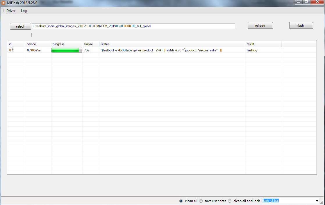

I had unlocked bootloader Twrp 3.2.2 and xiaomi.eu 10.0 stable
I successfully updatet twrp to 3.3.0 and tried install xiaomi.eu 10.3 stable (pie)
RESULT: system has been destroyed !
fastboot was working but win7 not recognized device
I managed to run eld mode (vol + and - and plug pc cable)
I run miflash and flashed rom from screen
I took endless time...
after restar system is still destroyed,
I can run fastboot and edl
Fastboot now recognize device, bot cant flash recovery. Error device is locked now :(
Miflash by fastboot also returns error that device mismatch.
I flash again edl mode, but again it take 1000second and progeressing endless like before.
Please help ! ! !

Maybe i can try miflash official china? stable or developer ? latest miui 10 or old 9 ?
I don't think you can use miflash as long as the bootloader is locked.
You should only flash the same ROM type as your device - China or Global.
Stable or developer is not so important I think.
No old version I would think - Sakura has ARB.

In your first post you show miflash trying to flash a "india_global" ROM? "sakura_india".
I read somewhere that Xiaomi has started making special Roms for the Indian market.
You should probably only try to flash the same sort of ROM that was on your phone when it was new, but the latest version because of ARB.

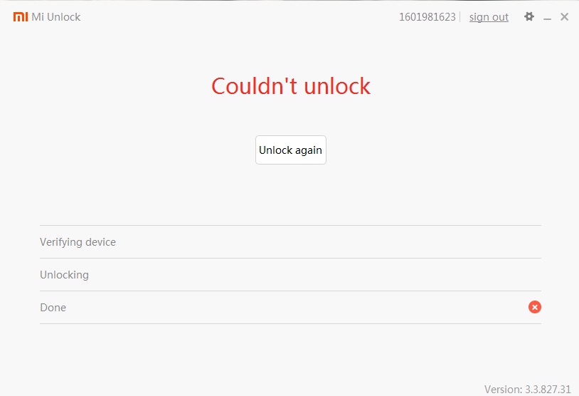

Unlocking the bootloader may be a way to go...

Go to cmd
Copy this into cmd : cd C:\adb
After that, connect you're phone in computer (fastboot mode) and try this: fastboot oem unlock
After that, I hope than unlock you're bootloader (I don't say if it work...)

Try this:
1-Open CMD
2-Copy that : cd C:\adb
3-Write that : fastboot oem unlock
4-I hope than unlock you're bootloader.
(I don't say if it work....)
