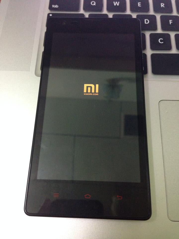

i have redmi 1s. i was pasted something on internal storage/system ( i cant remember what it is) then when i rebooted, the phone stuck on MI logo. i though my phone was brick.
then i tried to unbricked it again by using this fasting boot
JHCCNBF31.0/armani_images_JHCCNBF31.0_4.3_cn_92252c0764.tgz
JHCCNBE29.0/armani_images_JHCCNBE29.0_4.3_cn_069aa53411.tgz
i tried both. and all the operation completed successfull using miflash but still the phone stuck on MI logo
[image]
[/image]
anyone can help me? really appreciate.

I got same problems with you, n solved. My 1s still can boot into miui recovery.. and wipe data..wipe cache..finaly wipe data (lost data .never mind).. try to reboot ..n it work on me..

My Device stuck in MI logo too.. I try to get into MIUI recovery WIPE & Reset --WIPE ALL User data..
