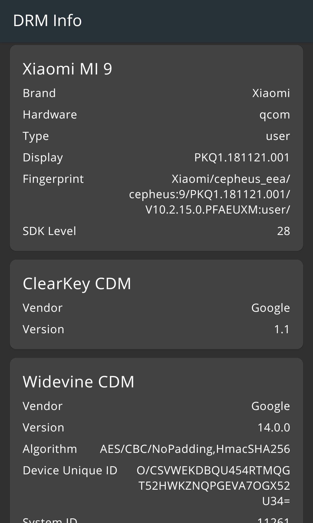

how to check what the device ID is on genuine software?
On DRM info the fingerprint is: xiaomi/cepheus so i dont have to edit update script etc.

I am on the below DRM.
The ROM is globale from the shop but missing alot.of tools like email app or agenda . There just build in apps of MUI.
My phone is not unlocked yet . I have to wait 360 hours.
