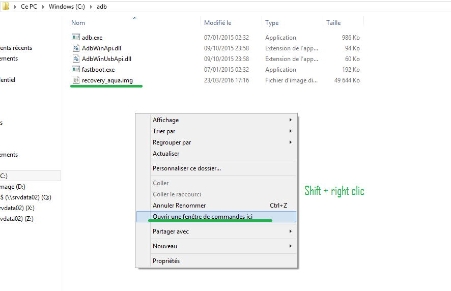

    2. Custom Recovery
    • Type "fastboot devices" and press Enter just to be sure your device is correctly recognized.
    • Type "fastboot flash recovery recovery_aqua.img" and press Enter to flash the recovery
    [​IMG]
    Now you're recovery must be the TWRP. You can now install the rom (*.zip) from it.

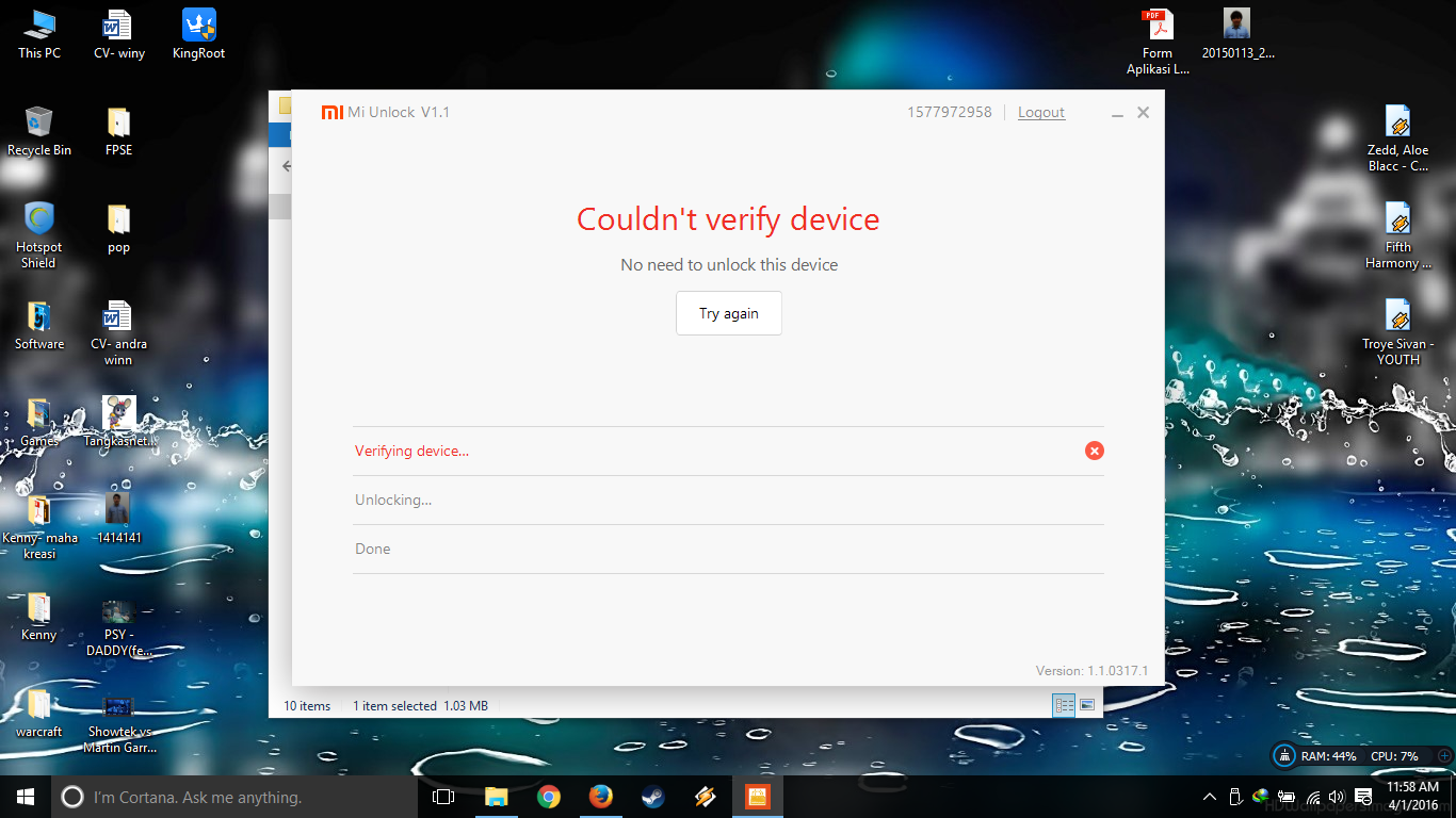

    #6ioryboy,Apr 1, 2016
    please update the link
    had I could not get twrp. I've unlocked exit HH same picture usb plugs
    I try in rom v7270
