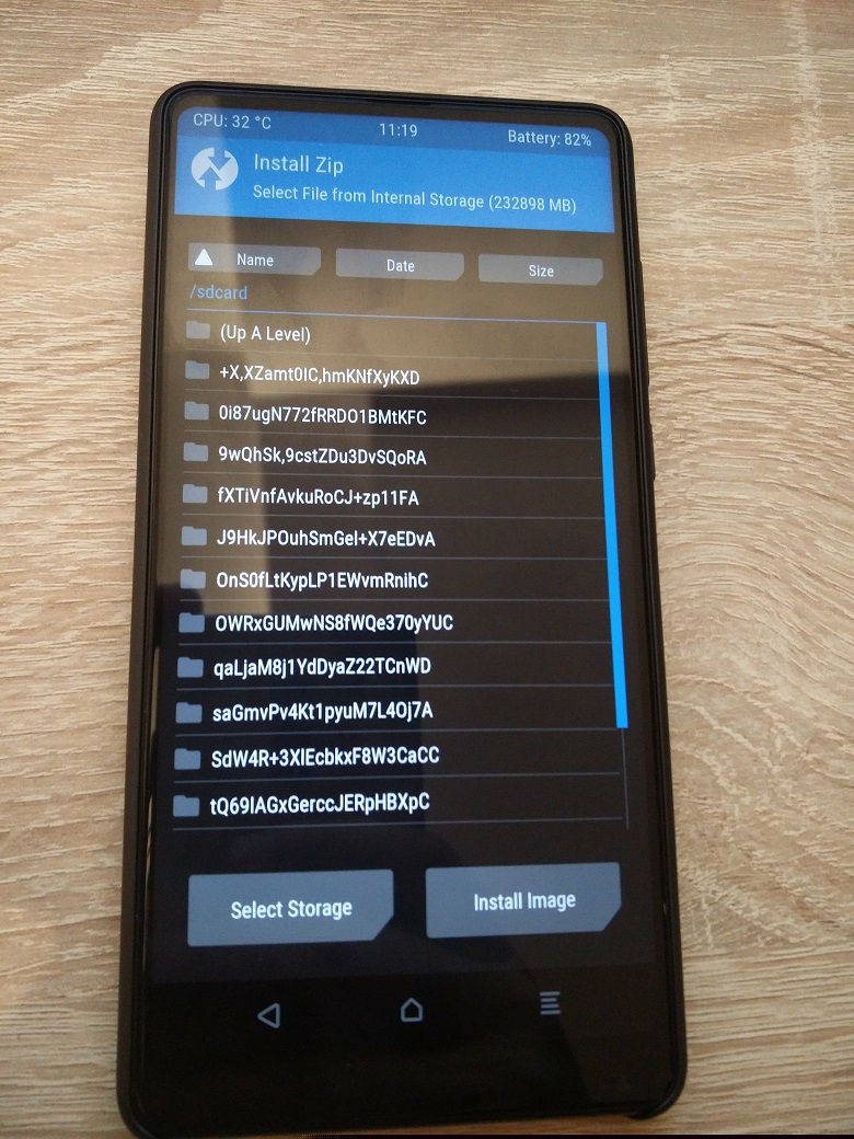

Seems not working for me.
If i force via cmd to reboot into the twrp it works for this time.
But 1.) net recognized via usb as thumb drive by windows, 2.) cryptic folder names
Also strange volume up + power if device was off leads to old xiaomi recovery
I made something wrong or whats going on ?

After shutdown booting miui and shutoff - powerup by volume up and power i land on stock recovery
Says unlocked on bootup - and yep i did it
Or is there something special - i just used the xiaomi tool to do this - no reflash of anything after this
As said the system status says unlocked - also on boot the "lock" symbol is unlocked
Edit: Mi unlock SW says also device unlocked , u dont need to do it again
Yep its global stable.... (newest)
As long i dont boot the OS after flashing TWRP it works several times until os boot. After booting to os and reboot the stock recovery is (back)there.
Yes, when the operating system restarts, the recovery file is restored from the recovery-from-boot.p file
So ok - my fault
How to avoid this ?
Second- why cant see the phone as thumb drive in windows while in twrp main screen ?
Third- whats the location of /Downloads if i put the file there while in Miui - i had only strange named folders in TWRP nothing real to deal with
Thx for ur support - nice service
Twrp automatically transforms the recovery-from-boot.p file into recovery-from-boot.bak
Install twrp with fastboot and restart in twrp always with fastboot... then Wipe -> Advanced Wipe... select Dalvik / ART Cache and Data and Swipe to Wipe
This lead last time to non booting OS- extrem long boot cycle never got into OS
No problem if i can transfer a new image to TWRP accessable storage but as mentioned above cant find the "download" folder and also phone doesnt get detected as storage while in TWRP
Jep - even if this works, whats about the strange names in TWRP for the storage - cant find my download folder or is this linked ?
Cant enable usb on TWRP why?
Why is this like it is ? Never got that troubble with TWRP install on any phone.
Cant get the phone recognized as usb storage while in twrp and cant realy browse the filesystem because there are strange names
