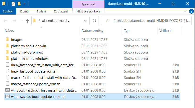

1, - If the downloaded ROM has the name fastboot, it installs in fastboot mode. You cannot install it in TWRP.
2, -use Windows:
-Unpack downloaded zip file in the PC
- Connect to PC via USB cable
- Run fastboot installation script from unpacked zip windows_fastboot_update_rom.bat
- wait for the phone to restart the system
3, - All data is preserved.
